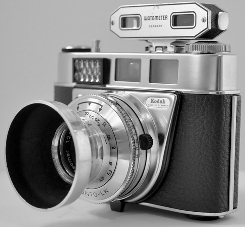

I just used mine with a Watameter rangefinder accessory on the top like so:
Kodak Retinette IB (Typ 037) Kitted Out by Morinaka., on Flickr
