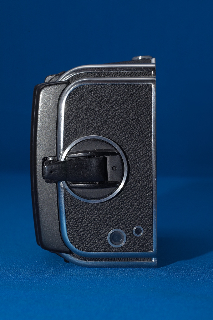

Anyway, a couple of test shots both taken with the back mounted on my 501CM at 50 ISO and with the Planar 80mm f/2.8. The first shot was using a 21mm extension tube.
A12 small by tonky8203, on Flickr
Full size version here...
http://www.flickr.com/photos/tonky8203/6123733952/
