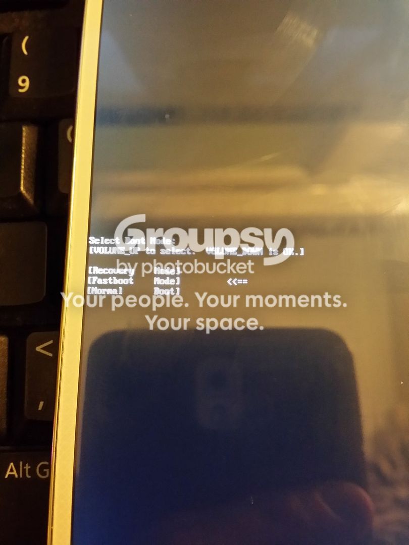

Thanks guys.. dave1, I tried that, got to the boot screen although it's upside down!! I can scroll through the 3 options , recovery, fastboot or normal, but can't select one when I press any of the buttons..
Are you sure you are pressing home+power+volume UP?
You should have more than 3 options.

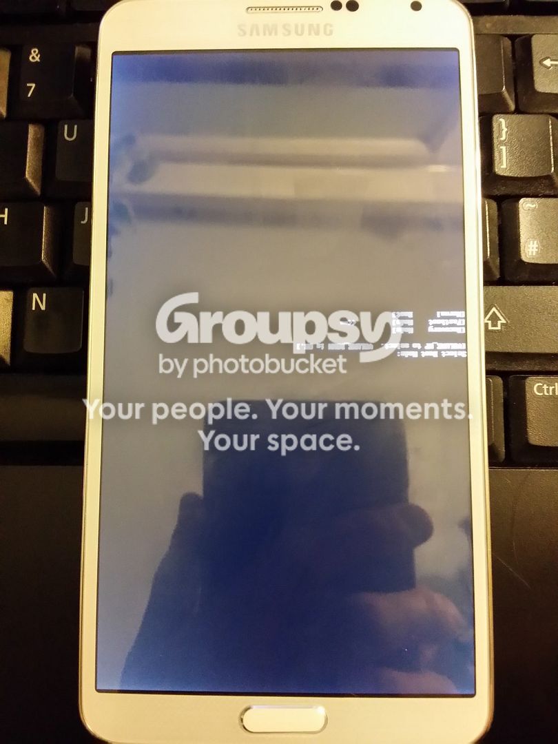

The s-pen doesn't show a dot.. it's a hard tip.. ran that app.. so not sure it's a note 3.. calling it a SM-n9000, which is what it says on the box..
Bought off gumtree.. so not a trusted source.
I suspect you have a fake, that boot screen looks like a Chinese Mediatek.
That's also probably why you have all the adverts and pop ups, there isn't any easy way to get rid of them.

They are often baked into the OS, sometimes it can be possible to root to remove but on some versions they can also masquerade as system files making it almost impossible.
Problem is, there isn't a single clone model, there are a large number, made in different factories, running different firmware and with different add-ons. Some are virtually impossible to tell apart from the genuine item visually while others are easier to distinguish. It's always the S-Pen that gives them away though as none of the fakes have that feature.
If you can pin down the actual hardware you could be able to find a way to root it and then hopefully delete some of the malware.
I would be going back to the person you bought it from and get your money back
