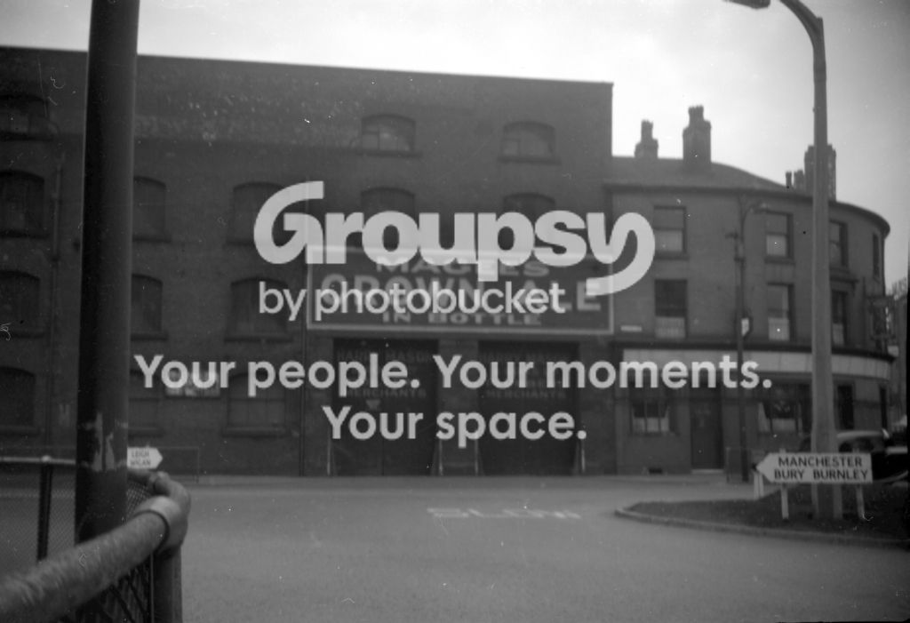

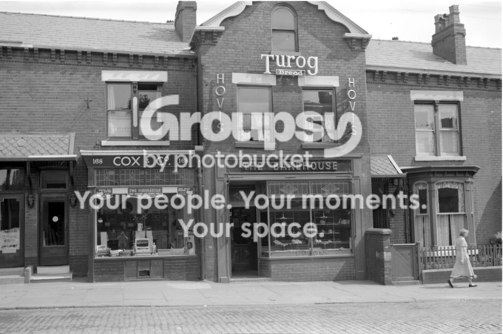

here are a couple of examples of the best and worse so far out of the 70 or so i have scanned
these are just scanned and not processed in any way
out of focus
in focus

I *think* the telegraph pole on the left is in focus here, so my uneducated guess would be photographer error. I'm guessing these were taken with a scale-focus folder?
just done a few more and looking at the negatives using the light box app and a 50mm lens ( never considered using a 50mm lens as a loupe thanks for the suggestion ) the ones i looked at are all in focus so the soft focus scans are down to me :(
i did a quick experiment by sandwiching a negative between a thin piece of glass and the surface of the scanner and the focus using that method is spot on but it's a bit too fiddly to be a practical way of scanning them in. some sort of holder using that method would be useful i just need to figure out how to make one i have an idea that might work which will allow me to scan 2 or 3 at once
