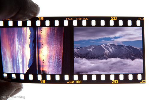

you can do it without a lightbox, the results wont be great, but good enough for web use. use a flash on an off camera ttl chord pointed at a white BG behind the slide (diffused as possible with a bit of +ve comp), then take a photo of the slide.
eg.
that is 135 film, so 6x7 should come out pretty decently.
