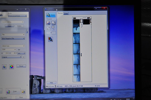

@BY tried that, right here is what im getting on the left is the other roll and on the right is the mystery roll
DSC_0341 by walsh0222, on Flickr
Also scraping the barrel for an answer ;).....You have it set for 48bit color erm but you should still get something.
Any chance you can take the same picture but put a piece of each roll up against the screen too? (along the white strips)
Two possibles spring to mind here, the first is that there are small holes in the end of the carrier which must act as some sort of reference for the scanner, make sure the tail of the strip is not covering these. Second, sounds obvious, but is the carrier mounted in the correct direction, ie two strips on the light?
There are no spaces between the frames even in that picture, but is the black space at the top the film leader?
Flipping the film makes no difference, you just get back to front scans, but there is something very odd going on for it to not show up at all. It looks exactly like the surrounding neg carrier which is entirely opaque, but if there is an image there which can be seen then it obviously isn't opaque :bang:

From the screenshot, I'd try grayscale and not 48bit colour, and I'd try setting to display thumbnails instead of drawing the boxes for scanning. Only as a test at least.
