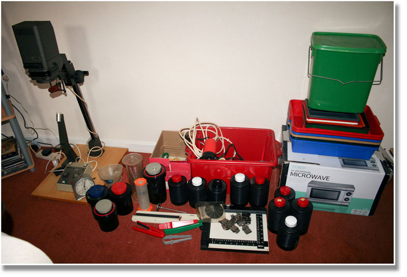

Darren PM sent Complete B/W Darkroom everything needed Clicky To Thread :thumbs:

Coo - an enlarger with speed stripes eh... :thinking:
