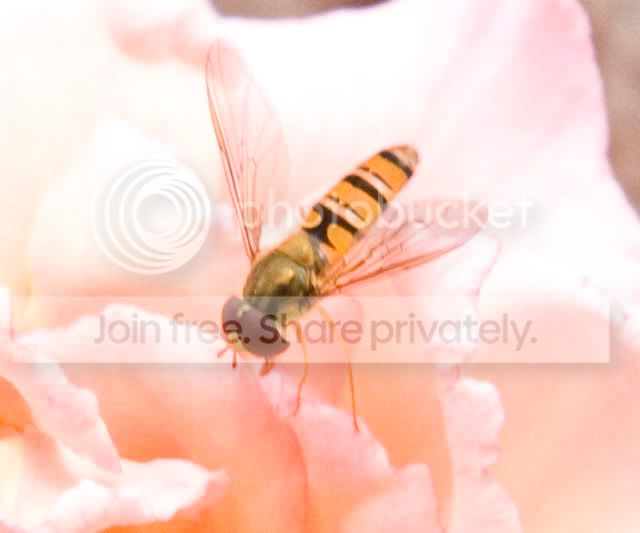

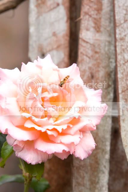

I have just recieved this lens and want to make sure it is as sharp as it should be.
Pic is straight off the camera.
1/500
f8.0
iso: 1600
100% crop
Thanks
I've got the IS version on a 40d, and even at f/2.8 I get shots consistently sharper than the one you posted. Might be worth taking a few other shots, maybe on a tripod if you haven't done so already, one image alone won't be a good test.
