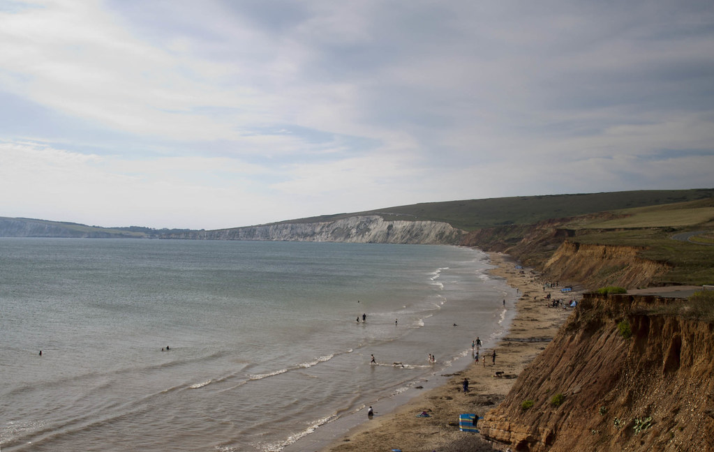

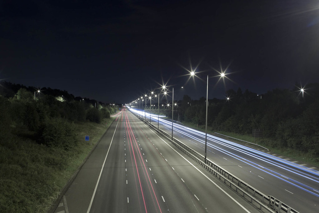

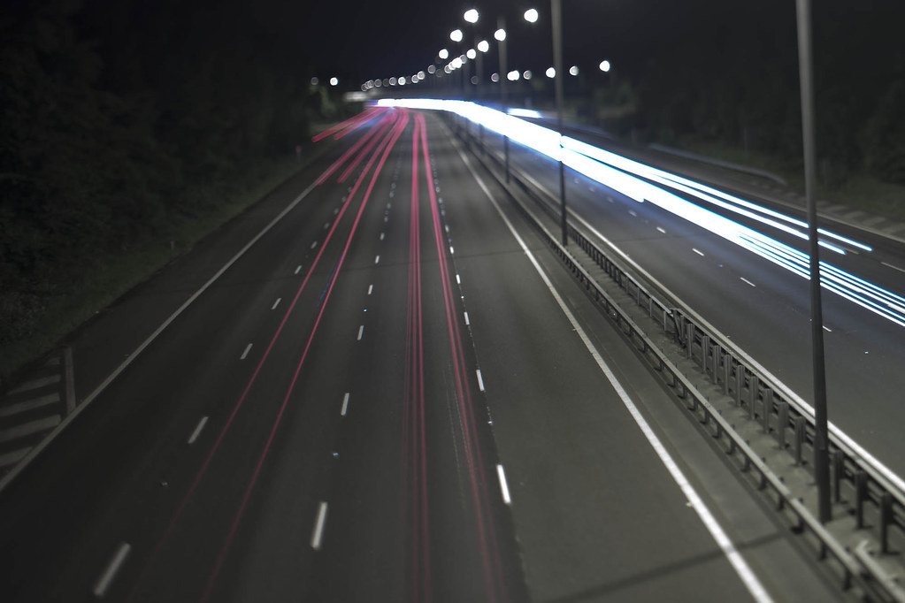

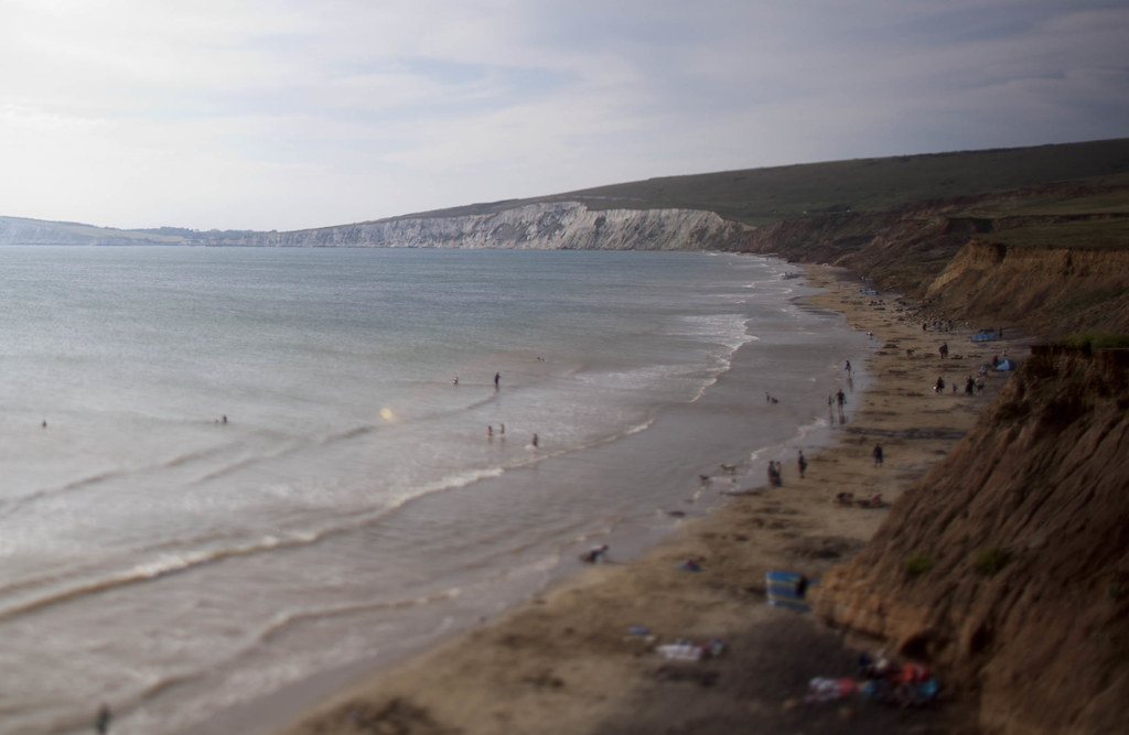

So a couple of back to back straight and true (S&T) vs tilt and shift (T&S) images from roughly the same location, at the same time:
M40 S&T:
M40 T&S:
Compton Bay S&T:
Compton Bay T&S:

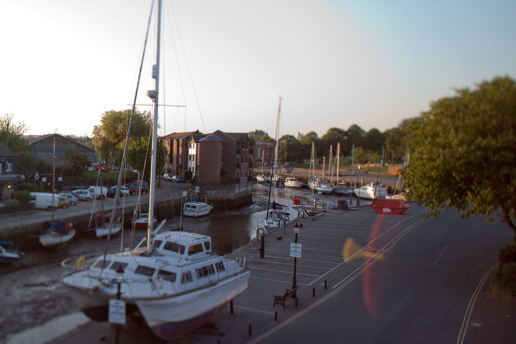

and a really weird effect from the sun on this T&S image of Newport harbour:
The thing that bugs me about shooting T&S is that it nearly always seems to wash out the colours when it's wound right over. Any insight into this would be really helpful.
