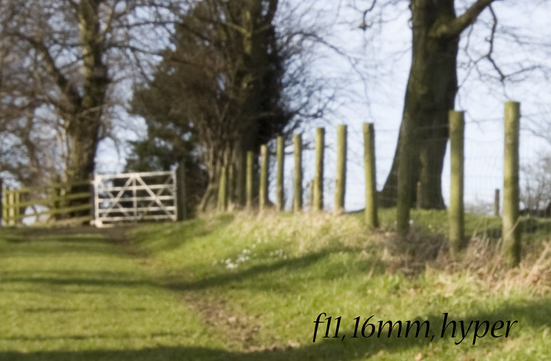

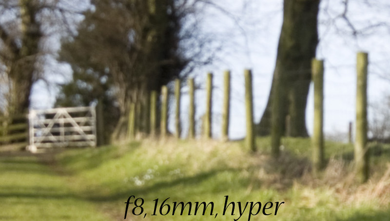

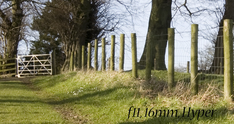

These are a few I took yesterday.
They were all taken on a tripod, using 2 second timer to minimise movement and hyperfocally focused on the white snowdrops at approx 15 feet.
The focus was set the same for each picture.
Test 1 by cowboy72, on Flickr
Test 2 by cowboy72, on Flickr
Test 3 by cowboy72, on Flickr
100% crop as shot.
MF on lens
AI focus on camera.
Focused at just before infinity (5') on lens for f8 and 4' for f11.
Thanks

So the focus was adjusted manually between each shot ? were you going by the scale on the lens or did you look through the viewfinder ?
Go back to 1 shot auto focus and start from there.
If you are manually focussing keep in mind that infinity is a variable thing due to temperature/air pressure etc. So one day it may be to the left of the "hockey" stick, another it will be to the right.

So what distance did you use? Those pictures look very near-focused to me. Hyperfocal distance for 16mm lens at f/8 is 6.4ft. Ignore the lens scale markings, they are usually inaccurate, sometimes wildly. Estimate six-ish feet by eye and focus on something at that distance using centre AF point.
Hyperfocal distance is a technique for maximising depth of field, not for testing sharpness. Only the actual subject focused on will be optimally sharp.

I used the SimpleDOF meter app on my phone.
16mm Focal length at f8 for 15 ft came out with 5ft 6 inch hyperfocal distance and I used the scale on the lens.
Looks like the app is a bit out, with my "guessing at five and a half foot on the lens scale probably accounts for the focus problems.
Thanks very much for your help :thumbs::thumbs:
Try this DoF calculator - DoFmaster http://www.dofmaster.com/dofjs.html You can donwload it as a phone app.
Your DoF app may be calibrated to a different standard, or be set for the wrong format. Anyway, DoFmaster above uses the international standard.
DOF calculators are only good for checking / working out the DOF after you've focused, the scale on the lens is about as much use as a chocolate teaspoon :)

so that's about 1.5m in proper units? I'd go for 2m for the start, so that's close enough... And the camera didn't override the focus in some strange way, did it?
So that looks pretty awful if your focus was anywhere near infinity. If you didn't tell use I'd say that's more like 30-40cm. That points to something very faulty in the lens assembly (and I am not surprised with that at all).
Get it back to the shop or send away for warranty repair as an alternative.
