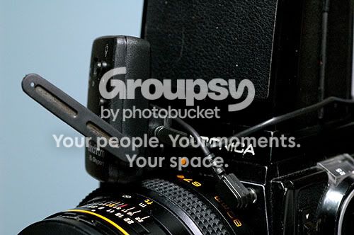

cherryrig, I'm also keep to find out how you use your skyport/strobbist setup with the Bronica SQ-A (y)
This what I do -
Basically just use the 2.5mm to PC sync cable that came with the Skyports, wrap the cable around then plug in the transmitter. Therefore by doing that it's not going to fall off or be lose in anyway. Then away you go really
Hope that helps you out??

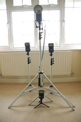

I bet there's some proper power in that QFlash. Did you get the battery situation sorted?
Yea I did get a charger in the end. It came today actaully :)
Some really power in the QFlash!!! You should see the strobo mode!! :LOL:
I can get photos like this now, if I wanted to :LOL:
Just leave the camera on a long shutter and then the flash just flashes like a strobo :D
