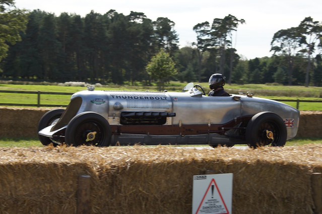

If you're shooting side on and don't pan is there any shutter speed where the car will be sharp when they're doing between 20-50 mph?
I was at carfest earlier today and had a good straight spot where the cars were side on and not going madly quick.
I did find that liveview was more hit and miss than using the OVF. I was using the screen as I really wanted to see the cars and was taking a shot as they went by after pre-focusing where they'd go passed. I used the 28mm end so there was a wide opportunity. This didn't work well!
Panning in the normal fashion was much more successful. I was using AI mode which is single focus when stuff is still and continous when they aren't. I'm wondering whether continuous would be better? There were some instances where the car was only in focus at the beginning and end of the pan where they were similar distances from me. I did use the wider end more as I'm not coordinated enough to pan and change zoom level at the same time and I needed the wider end to get all a car in as I was fairly close to them.
I used shutter priority and set to 1/320th which I thought was fast but so fast you'd get no blur of anything at all. I even used matrix metering which is normally mental but it seemed ok when using S mode. What's a reasonable shutter speed to get some movement blur but without having too much opportunity to blur the car too much?
One of the better ones:
Untitled by srichgtr, on Flickr
Another day of it tomorrow so any suggestions on what to try next?
I did on their return. I wanted to have a good look at the cars as they went out so was idly catching them when they floated in front of the lens. On the way back I did the proper pan method. I was just wondering what shutter speed would be necessary for the idle method :)

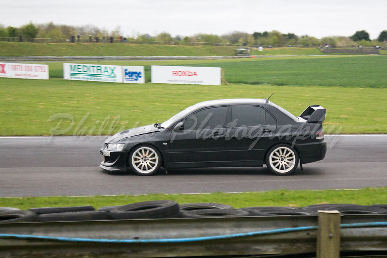

Although this one is actually a pan, i was trying to freeze the car because i wanted to try and catch the brakes which were glowing red (failed on that part) and to give you an idea it was shot at 1/500, its a poor picture because i only had a 18-55 kit lens and its a heavy crop but you get the idea

The glowing brakes show better at lower shutter speeds being brighter than the blurred wheels.
Worked that one out afterwards :bang: was VERY new to photography at that point :lol:think actually it was my first time doing panning
