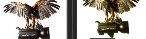

Fast-forward to today, very little gets printed and nearly everything is viewed on computer, and the average viewer doesn't have a calibrated monitor, so colours are all over the place, nobody notices and nobody cares. Two of my monitors are calibrated correctly, the third one is a cheapie that I use just to keep my tools or documents, the colours are hopelessly wrong, and sitting here and moving a photo from one of the calibrated monitors to the 3rd monitor shows just how far off it is.
So, that's my long answer. My short answer is that whether the colour shift matters or not depends on a lot of different factors, and what matters to one person may not matter to another.
