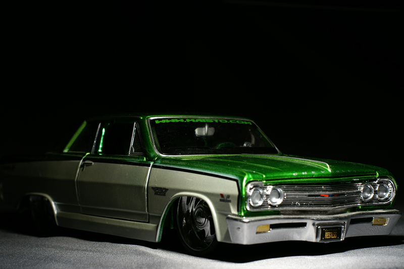

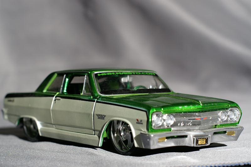

The light fall off thing works on all sorts, here I've photographed a model car inside a light tent and I've managed to make the background black by placing the light closer to the subject.
Strobist info for 2nd exercise.
Flashgun-1/4 power-6ft
Camera-1/125-F7.1
Camera-1/125-F7.1
Flashgun-1/128 power-6 inches
Camera-1/125-F11
