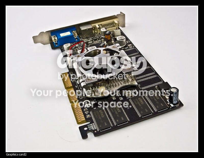

Have a look at this, quite an old thread but its the sort of thing you are talking about taking pics of.
http://www.talkphotography.co.uk/forums/showthread.php?t=255818
Tinyspark borrowed my cheap ebay lights, which worked well, and she did the shots with a backdrop. If you feel the end result was acceptable then you can see sort of thing that is achievable at bottom end of budget.

Yes, I remember that thread and she did well to go from terrible results to results that she personally was happy with. I think that that thread proves that some kind of results can be achieved with cheap lights, but it's much easier to get good results with good equipment, and virtually impossible to get consistent colour temperature and consistent exposure without good equipment.
Those lights are fine Garry, you have never used them nor seen them to comment.
They have been used alot, and I am getting consistent colour temperature and exposure from these lights. Once my shots are set-up they are consistent, and all look the same.
People on this site use all sorts of different makes and models of cameras to suit their budget, lighting is the same.
The OP can get a lighting kit to get acceptable results within his budget, Tinyspark was completely new to studio lighting, and she was happy with what she got, and so was the customer. At the end of the day, thats all that matters.
