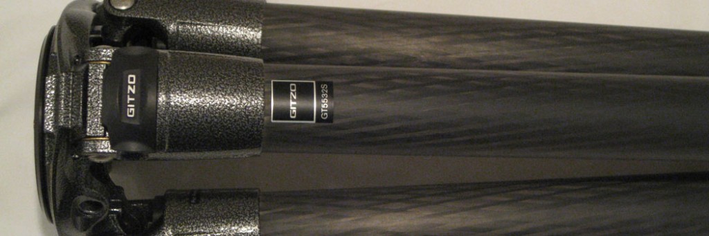

I have a Gitzo GT3543XLS which extends to around 7 1/2 feet it is invaluable when on slopes or when perched on a rock for extra elevation. For stability I use 4 inch spikes instead of the rubber feet they make an incredible difference.
