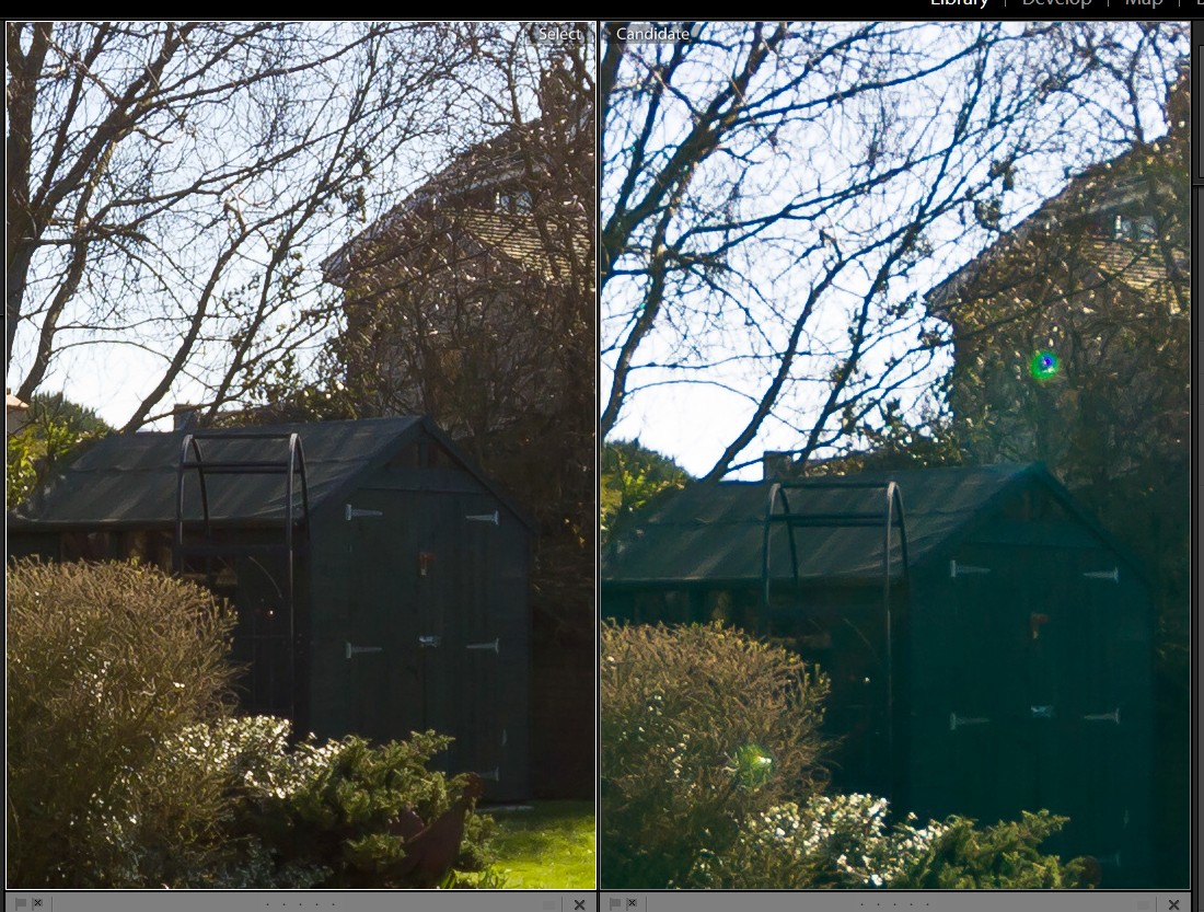

The reason I don't use the Tokina for anything else is that it suffers horribly from flare. If the sun is anywhere near the edge of the frame then you're almost guaranteed ugly great blobs all over your image. The Canon, OTOH, is one of the most flare-resistant lenses on the planet. And with an UWA you're going to have the sun causing problems around 50% of the time if your outdoors and it's not cloudy (or night-time).

There is no difference in sharpness between the two. The Tokina does suffer from very lightly worse chromatic abberation. The Canon has a much better focal length range and it also has a closer MFD, which can be quite helpful.
Here's my oft-posted comparison between the two...
As a check on the sharpness I decided to look at a crop of these two images. I was wrong, they're not equally as sharp. The Canon is a lot sharper.

good comparisons Frank! ... not used mine much in sunny daylight situ's but i see your point, .. it does seem to come into its own at dusk or low light tho! .. so the f2.8 might have the edge there;)
oh and ...... your "gear list" is huge! ... hope you dont keep it all in that shed :suspect:
