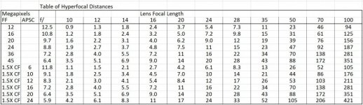

Required aperture for the shortest hyperfocal with full resolution at infinity is 43.2 divided by the crop factor divided by the square root of the number of megapixels.
eg A 16MPix FF camera needs an aperture of 43.2 / 1 / Squareroot of 16 = 10.8 then round this to the nearest aperture setting.

Hyperfocal distance = (Effective focal length /50) X (Effective focal length/50) X Megapixels X 2
The clever bit is by dividing the focal length by 50, you get "stops" at about 17mm, 24mm, 35mm, 50mm, 85mm, 100mm, 140mm, 200mm, etc
Every stop doubles the distance if they are bigger than 50 or halves it at if it is less. So now you have a distance of 2 X Megapixels which you then double or halve as many times as you have stops away from 50. Easy.

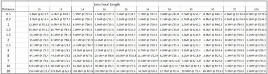

A 100mm lens (2 stops up) on a 24 megapixel FF sensor will have a hyperfocal of (24 X 2) X 2 X 2 = about 200m at f/9
What this will give you is the resolution of your camera at infinity, theoretically twice the resolution of your camera at the hyperfocal distance and the resolution of your camera again at half the hyperfocal distance. This should give you much better post-processing options than guesswork and also help with calculating focus stacking.

This method won't make good pictures in itself and may make all your pictures look the same. It won't necessarily make good art. It won't make a lens that is bad at a particular focal length/aperture/distance combination any better so you need to know what your lens is like. But knowledge is power. It doesn't cost anything to click your camera onto f/9 with about a 10m focus (for a 24MPix FF camera with a 24mm lens) to take an extra picture with everything in focus once the blurry arty ones with lower apertures are done.
