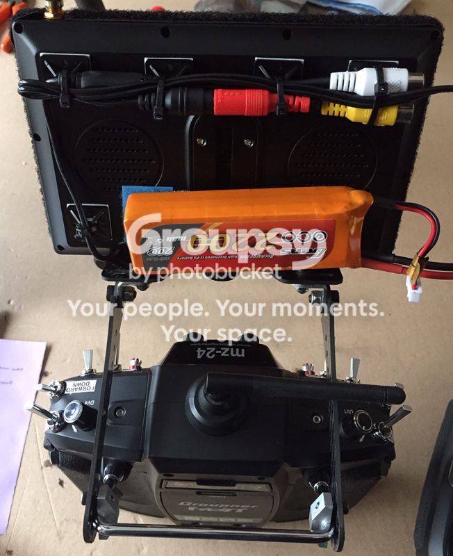

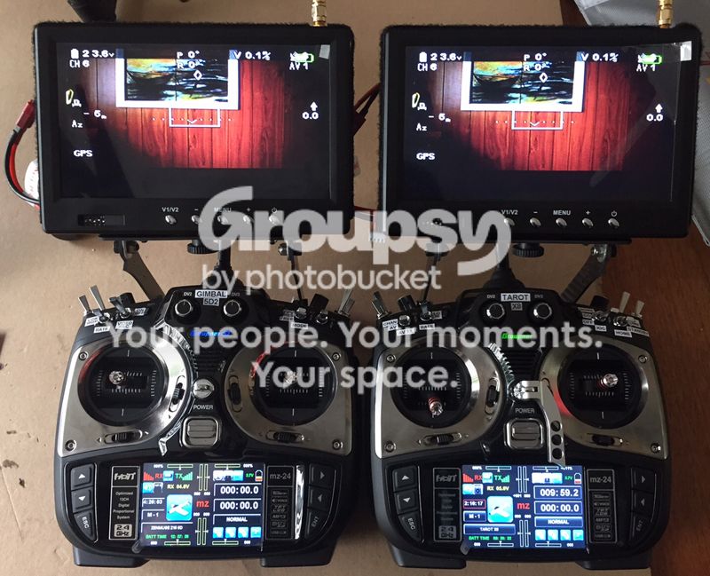

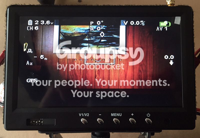

Hi, Next I had to finish programming the transmitters and fine tuning what I could on the bench, fit the video feed and also the on-screen display, to a monitor.
I was using the DJI AVL58 to transmit video from the drone to the monitor, and was going to use the receiver from the AVL58 to pick up the video feed but decided i didn't want another part with the monitor. Something i was looking for was to keep everything as small and self contained as possible, so i looked around for a monitor with a built in receiver ( of the correct band for the AVL58 transmitter). and found the Fieldview 777 32Rx monitor, with its 7" screen and built in 32 channel receiver, a battery was chosen which would run the monitor for about 3 hours, and a carbon fibre bracket was purchased to secure the monitor to the transmitter, this was done on bot transmitters so the pilot and camera man could see exactly what was happening with view from camera and also the data feed from the drone which was provided by the DJI iOSD2.
Shows back of monitor with battery in place and bracket to mount onto transmitter.
Monitor mounted to transmitter, showing live feed and On Screen Display of data.
Close up on OSD and data from drone (not all active as drone not flying)

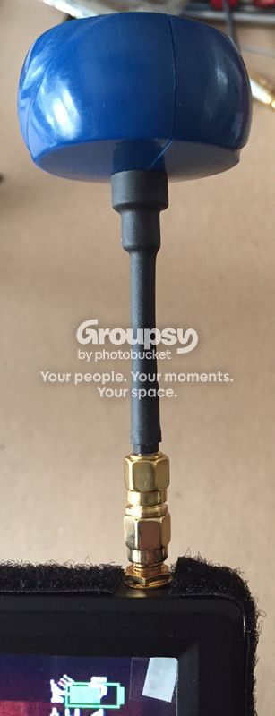

Mad Mushroom antenna, designed by legendary IBcrazy.
Next make up transmitters and check settings

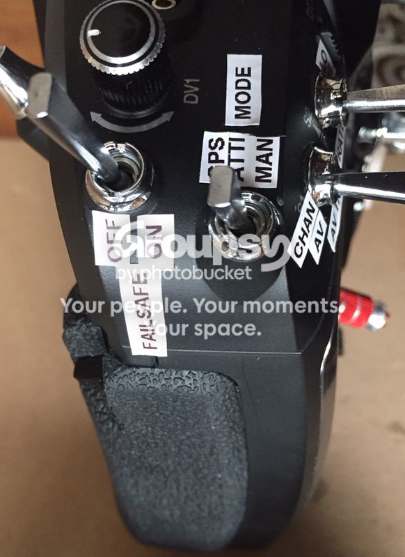

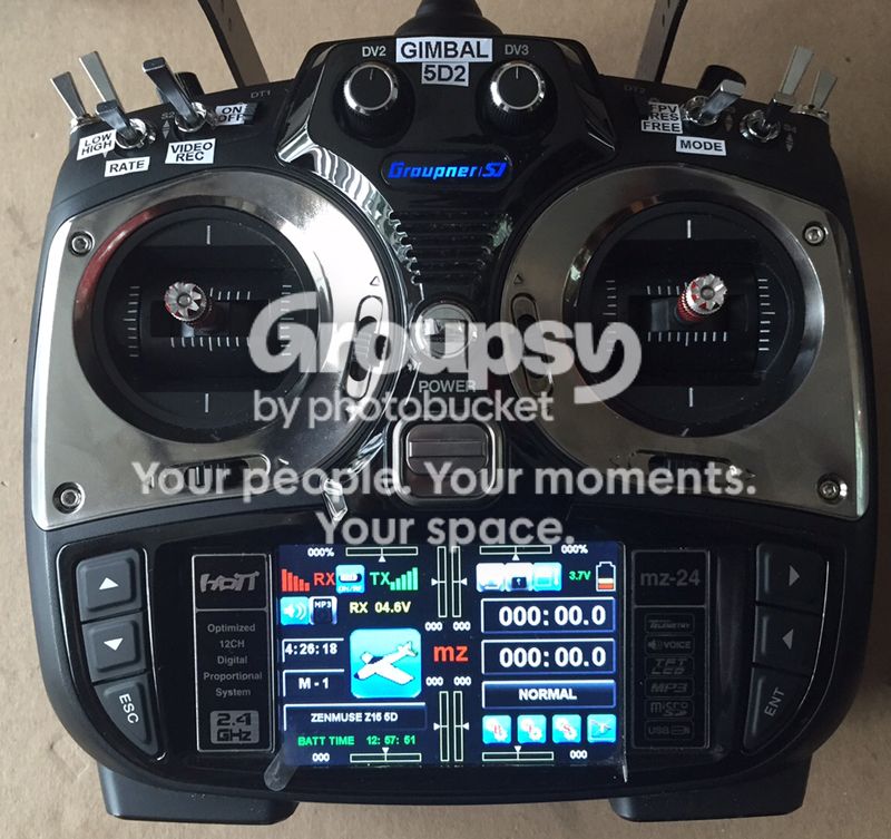

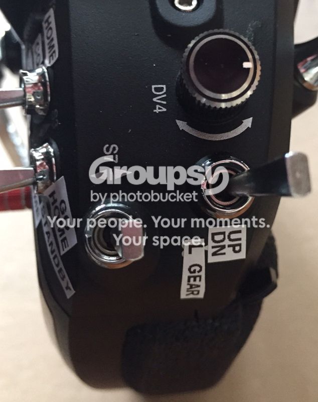

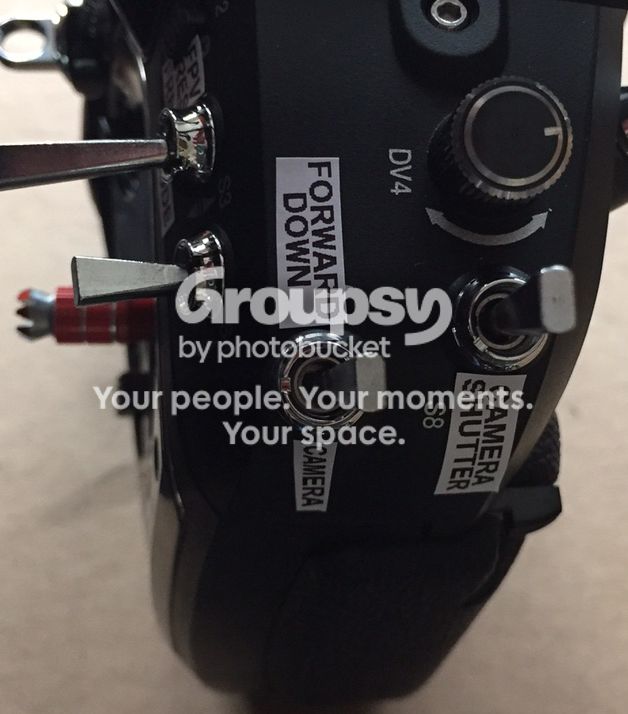

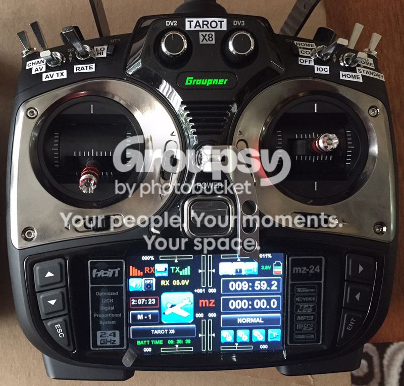

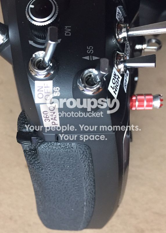

Next up was to label the transmitters and functions and to double check functions.
A small label gun was purchased so I could label up the transmitters, hopefully so no confusion can be had while using them.
Tarot X8 transmitter labelled up.
Dji Zenmuse Z15 5D Gimbal labelled up.
My initial start settings for the gain and attitude have been loaded in (im using the DJI suggested wookong M settings for the DJI s1000
as the characteristics should be around the same.

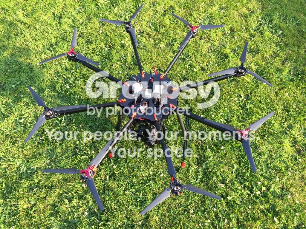

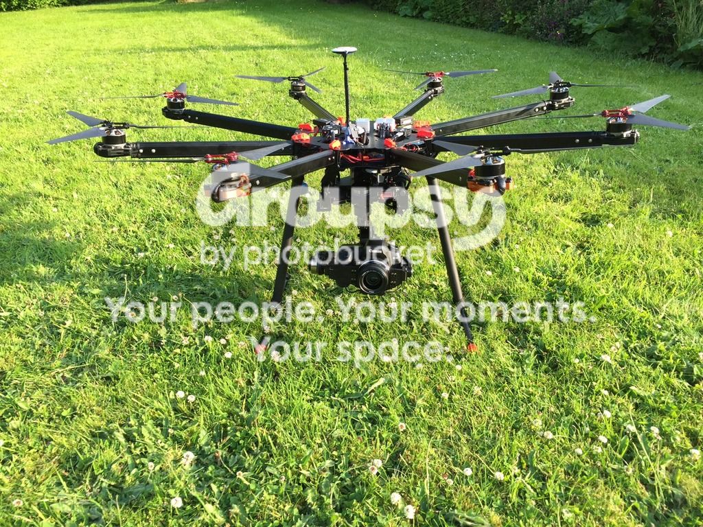

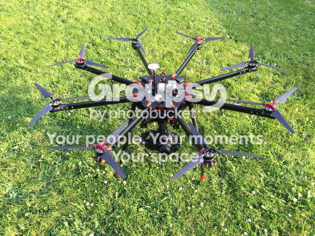

Hi everyone, well i finally got some nice calm dry time after i finished work today, so everything was outside for a flight test.
The mission today was to :-
1. make sure that full GPS lock could be attained from UAV to GPS satellites..
2. basic control of the UAV was OK and all movement controls worked.
3. a hover in GPS mode could sustained.
4. retracts work without any undue problems.
After these were done, it will be gain testing & tuning, from my initial settings.
Drone was weighed and its All Up Weight AUW is 9.6Kg.
With some calculations done I am expecting a mixed flying time off approx 8min per 16000mah battery.
here are some photos of the UAV ready to go,
Sorry the video is a bit small, will try better next time.
Video shows UAV in GPS hover mode with throttle stick at 50% no input from controller or me at all.
Test was a success, the gains were quite stable but will need a tweak, i got no undue wobble, hover was stable with minimal wondering and very little loss of altitude,
after a stick input UAV responded nicely with no adverse after wobble.
I got about 7.5 mins from the battery before my first battery limit was hit, at that point test stopped.
all in all I was very pleased with its first outing and looking forward to more.
As always i will continue to update this thread as i go along.
thanks for looking.
