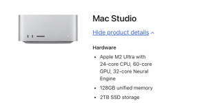

I am currently using a Mac Studio, with a M1 chip and 32GB Ram. My current set up is very slow when processing 100 megapixel Hasselblad X2D images in Photoshop.
Am I going to see a significant speed increase if I go ahead and buy this new Mac Studio, or is the speed issue more to do with the software i.e. Photoshop ?

I'd say the main issue with your current setup is the speed of your hard disk. The 512GB SSD in the M1 series was noticeably slower than 1TB or 2TB.
Here's an excerpt from a Mac Rumours article a year or so ago.
Here is a summary with rounded numbers, below is Write and Read speed from BlackMagic with 5GB tests. There is some variation, up and down depending on exact spec of CPU/GPU across Max and Ultra, but not massive differences.
Write and Read Speed in MB/s (I think they have these the wrong way round as write is always slightly slower than read).
512GB – 3400 / 3000
1TB – 5700 / 5200
2TB – 6200 / 5300
4TB – 7100 / 5600
8TB – 8100/ 5900
So as you can see, you should expect to see at least an 82% increase in read speed and a 76% increase in write speed.
I have an M2 max Apple Studio with 32GB RAM and a 1TB hard drive and I never have an issue with performance, okay I'm only using RAW files from my Canon R1, R3 and R5 but I frequently work in Lightroom or Photoshop while Premiere Pro is chugging away in the background and I don't have any problems.
So in my opinion you should expect to see an increase in performance, a substantial one, 24 core CPU and 60 core GPU will fly, you've quadrupled your memory and you've got a much faster hard drive.
Apple kit holds value well so sell your current setup and offset that against the cost of your new Mac Studio. :)
Personally though, I think you would suffice with the lower 12-CPU and 30-core GPU model.

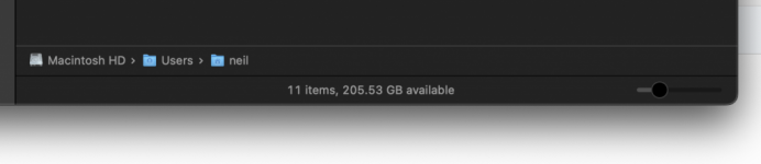

With 64GB RAM and a 1TB SSD (looking at your screenshot you're not desperate for 2TB, and it's much cheaper to add an external NvME drive for more storage) you can get it for half the price - £2,699.
Add in the money you'll get from your existing Studio and your outlay is significantly less.

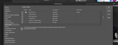

And before you spend the money, look into any potential issues like low drive space, incorrectly set cache parameters which is what may be causing the slowdown. You may still opt to spend but at least you have it under control.

Try switching your cache to the Mac Studio”s internal SSD and enabling full GPU acceleration - both should help significantly.

Cache levels could go to 8. or more. Could also go to advanced settings under use graphics processor and just double check all is ticked.
I really can't see anything major wrong here. Could be some 3rd party app interfering with setup. Something like antivirus or tweaking malware. Next step is really talk to adobe.
