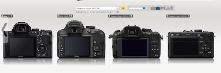

I use a Panasonic G2 mainly for the external controls, but, they aren't really small, about the size of a Nikon D3*** series DSLR.
This is part of the problem I'm trying to avoud cameras that big.

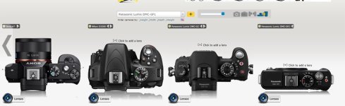

You could have a play with the camera size comparison site...
Sony A7, Nikon D3300, Panasonic G2 and GF1...
