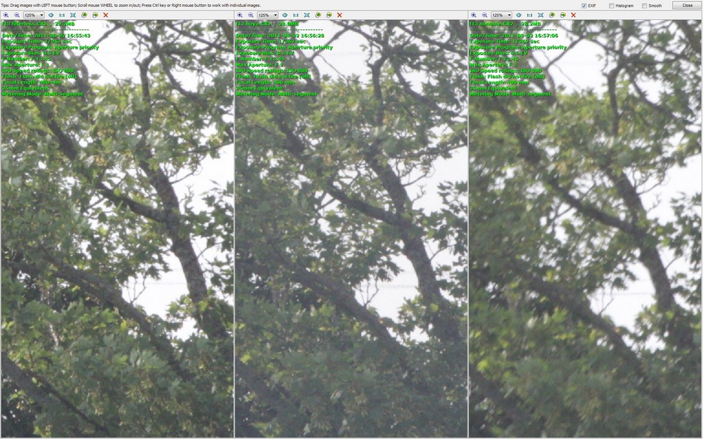

Here's what a Hoya HD did to my 100-400...
Unfiltered | Hoya | Cheapo
