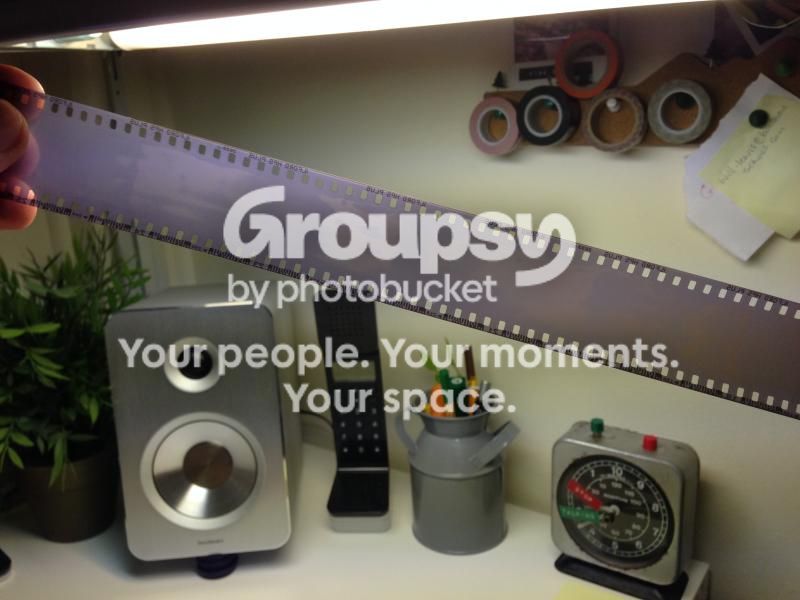

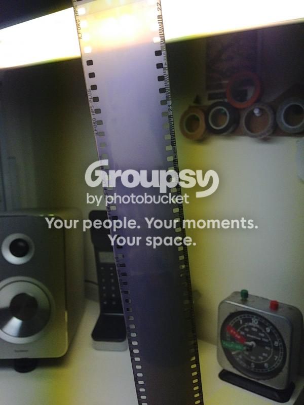

Here's a picture of the film itself - I only shot half the roll and this is what was left on what should have been blank film! Hopefully you can see what looks like a faint orangey-brown ghosting across the film?
Extra development time will give a small increase in density but a larger gain in contrast.
The normal descriptive adjective used to describe under fixed film is "milky". Does the film look to be a half way house between fully clear and the appearance of unprocessed film?
Is there any possibility that it wasn't loaded correcting in the tank and what you're seeing is the effect of uneven processing?
I've just shot a roll of Tri-X and developed that - indeed it came out 'milky' so I think it must be my fixer. I'll make some more up tomorrow.
yeah, I'm still going with fixer, not sure about orangey brown ghosting but it does look like fix failure.

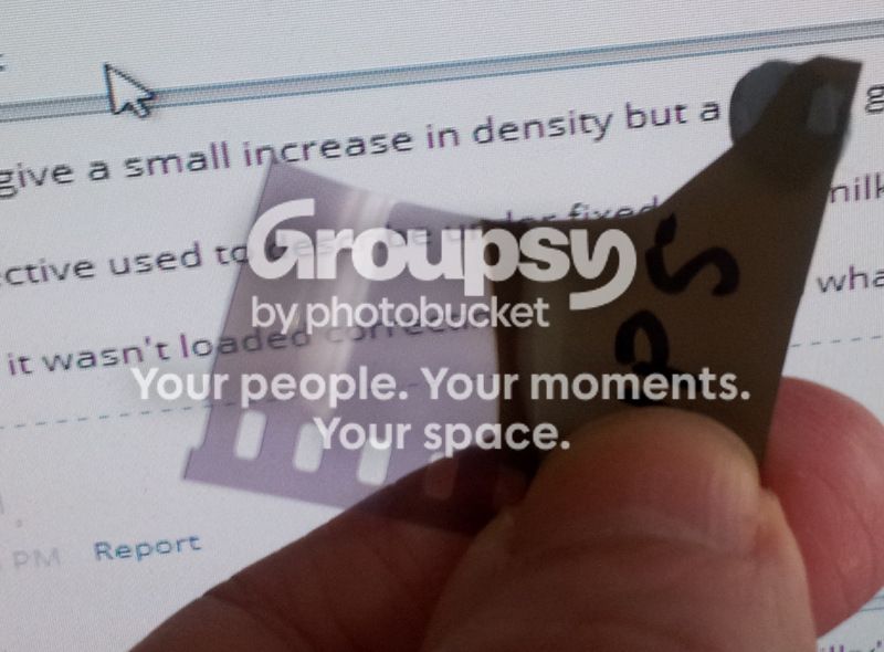

I would just try a clip test on the leader of the roll. This is one I did by dunking the end of a roll of HP5 in fixer for three or four minutes only. The film did not get developed first.
You can see quite clearly through it. I reckon that your fixer is probably exhausted.
