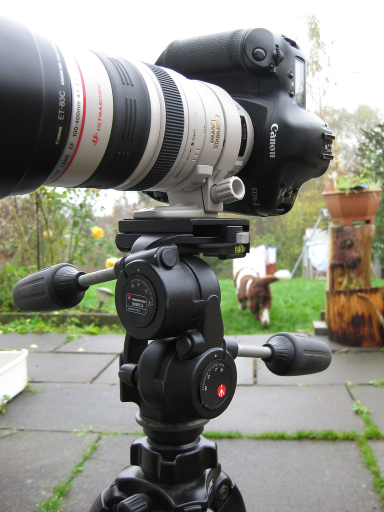

If I use a small body with a grip then the base of the camera is often lower than the plate. Same goes for a full size body like below. I no longer have this head but this pic shows one of mine rotated to portrait however if it was put back to landscape then the camera would be below the plate but I've no need to want to slide it forwards as that's balanced.
