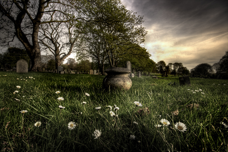

I would suggest a different approach. I do this with my 10-20 and it produces some brilliant results. You shouldn't forget that the DOF extends in front of your focusing point as well. So, at 10mm, when you focus at 30cm (min focusing distance for the 10-20 is 24cm), and use f/22, you get a DOF from 13cm to infinity.
Something like this?
Even though I did mess up a bit with my aperture used, and the trees in the distance are a bit OOF, but I still like the photo!
That's a good point actually! And I like the shot. :thumbs:
I think i'll do some maths before I pop out next time.
