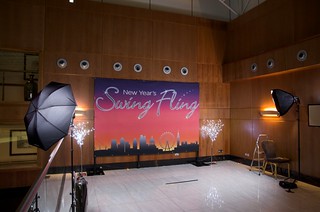

I've just got going with strobist stuff so I'm still learning my way. Shot this itch a portable studio setup:
IMGP7006 by Pheo, on Flickr
Inadvertant One Light Portrait by Pheo, on Flickr
The setup consisted of:
Key light: 1 Metz 58 AF1 mounted in a Cotswold Photography Foldable Softbox, on top of a heavy duty stand
Fill Light: Pentax AF360FGZ westcott combo white/shoot thru extra portable bounce umbrella mounted on Cotswold Photography Portable stand.
Mobile Studio Setup by Pheo, on Flickr
I, like you, don't have storage o have brought small/foldable stuff. I'm sure it ill take me a long while to outstretched the capabilities of the kit!
Any questions let me know. I think I've been in a similar place to yourself, ie just getting started.
