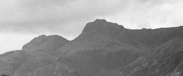

Good Morning,
What causes this artifact on edges, this is a pronounced area. I would hazard a guess that this was about a mile away and SOOC.
Note there is a black line at the junction of mountain top and sky.
HP5+ @ 800
HC110 7 1/2 at 20.4 finish at 20.1

Hi Kerry
Its a film shot HP5+
Certainly looks like digital (over)sharpening to me, as there is also a white line on the sky side. Is it there on the negative?
You can get edge effects (where there is a lot of contrast, such as where the dark mountains and light sky meet in your picture) when developing using some developers and certain development techniques. Someone more experienced in such matters (calling @StephenM :) ) will probably be able to provide a better explanation (if, indeed, it's the cause).

But you somehow had to scan it to show it here.
It could be edge effect from that process
I have just checked my "export file" parameters and indeed there is sharpening applied, unbeknown to me.
I will check the negative. (why didn't I think of that?)
Look up 'Edge Effect'.
Edit: Cross posted with Nige.
I just did, to see what was covered and if I needed to respond (other than with a "like"). It seems to be a very general term (my search engine had so many other uses that I stopped scanning down) so I tried "Mackie lines" with better success. Just in case anyone wants to look it up.
The artifact is present in the scanned image before exporting.
It is also present on the negative, the scan has picked it up rather nicely.
Perplexingly it is black on the negative
Acutance is another good keyword.
I had it in my head that Acutance was highlights for some reason, must read up a bit more.
On the nearest tree the highlights are white,
Thats wierd that near distance they are whit and far distance black yet middle ground imperceptible from the grain.
There are white highlights on the distant hilltops too, they're just difficult to see against the bright sky. The black highlights are similarly difficult to see against the dark leaves, although they are still there.
The middle distance is largely unaffected because the contrast is much less in those areas (it's mostly grey on grey).
