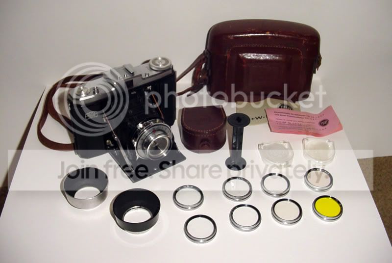

Anyone know what filter type/size would fit a Zeiss Ikon Nettar 518/16.
Picture of camera:
I am afraid that unless you can get a press-fit over the front you are out of luck, there's no thread that will take a filter on the Nettar.
Arthur
***edit*** hmm, bit of research...
Still looks like a press-fit over the focus ring though...
More research, closer to home this time, shows surprisingly (and rather happily too) that a 35.5mm threaded filter will, in fact, screw onto the focus ring backwards....
Coo - handy to know, and you can close the case with it on as well!
Arthur
Thanks Ambermile :thumbs:.
It's actually an IR filter (like R72) I'd like to get, but can't see any in that size.
There are step-up rings from 35.5 to a more standard size, but if you have to mount the filters backwards (:thinking:) then I'm guessing that won't work.
