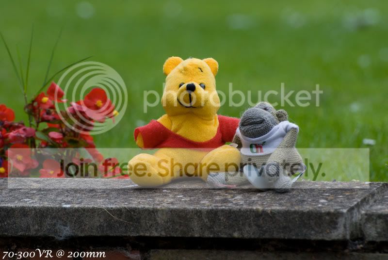

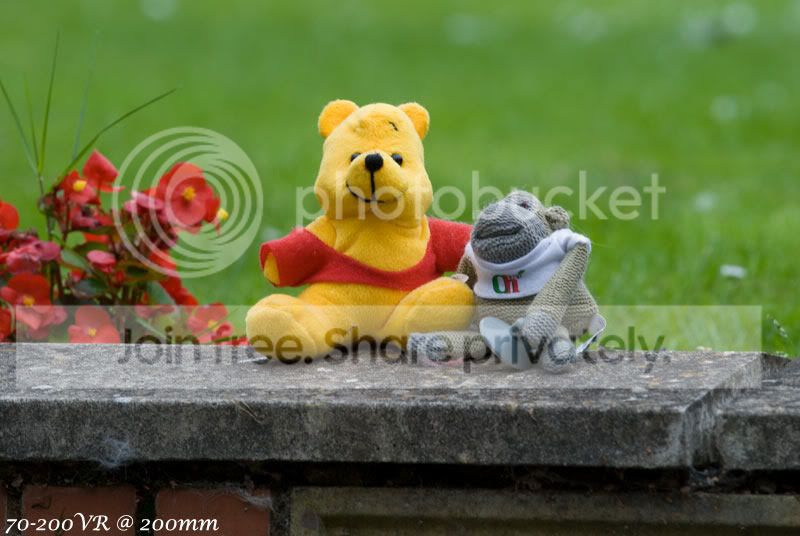

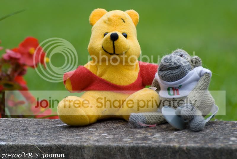

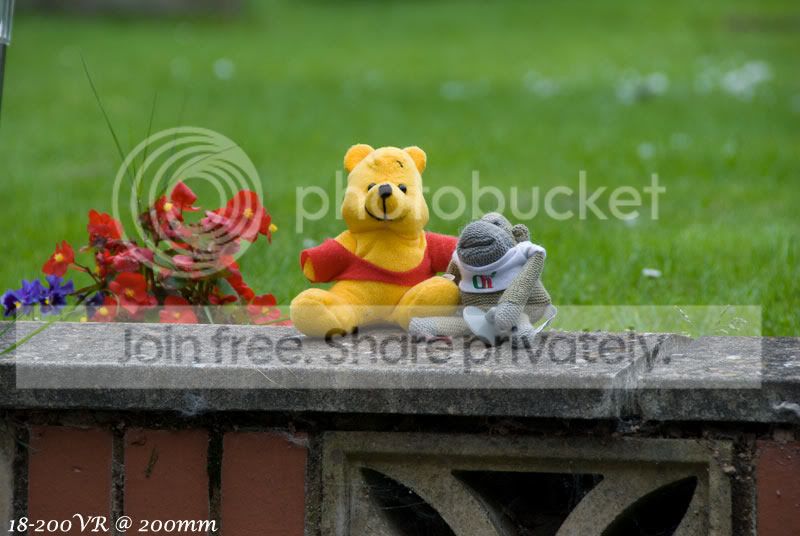

By the sound of it, the 70-300 will do you fine, I can do a quick comparison between 200mm and 300mm if you like?
Well, I've done it anyway and frankly I'm stunned.
It seems the 18-200VR gets nowhere near 200mm!
Ignore the softness in the 70-200, in the interest of accuracy I mounted the D80 on the tripod, not the lens. This meant I had to support the 70-200 with my hand and induced some movement. If my brain was on I'd have used VR, but it wasn't.
BTW. all shot at f/8.

That's a bit much isn't it :thumbsdown: That 18-200 is miles out. It seems like they've economised on the spec sheet too.
To be fair, everything that is specced on a lens always refers to focus on infinity and all lenses change focal length when they are focused. Some more than others and zooms are usually worse, and you are quite close in those pics.
It would be interesting to see what you get when framing a distant target. The 18-200 will fall short for sure, but perhaps by a bit less? Maybe.
Since you have such a splendid selection of comparable lenses, it would be interesting to see what the actual transmission is at lowest f/numbers. The teddies test target would be fine, just frame the image exactly the same with each lens, on A at lowest f/number, and see what shutter speed you get. Check the histogram to make sure it's as close too identical as you can get, maybe give it a dab of compensation to get the closest visual match.
My guess is that the 18-200 will need a little more exposure than the other two, and even when you've matched up the LCD images as best you can, the 18-200 will have slightly darker corners, especially at the wide end. Also take a peek at the line of the wall in wide shots - see how curved it gets ;)
Yep, I did consider the focus/zoom issue. I've read before that the 200mm shrinks to 193mm at closest focus distance, but that's still pushing it looking at that.
