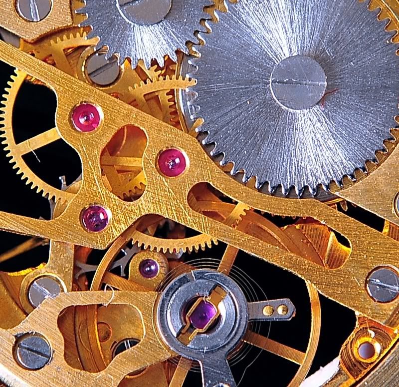

I have the 105mm Nikon, not the VR version. It's a fabulous lens, and used with a close-up filter, can get a lot closer. Here is a 1:4 taken with the 105 and filter:

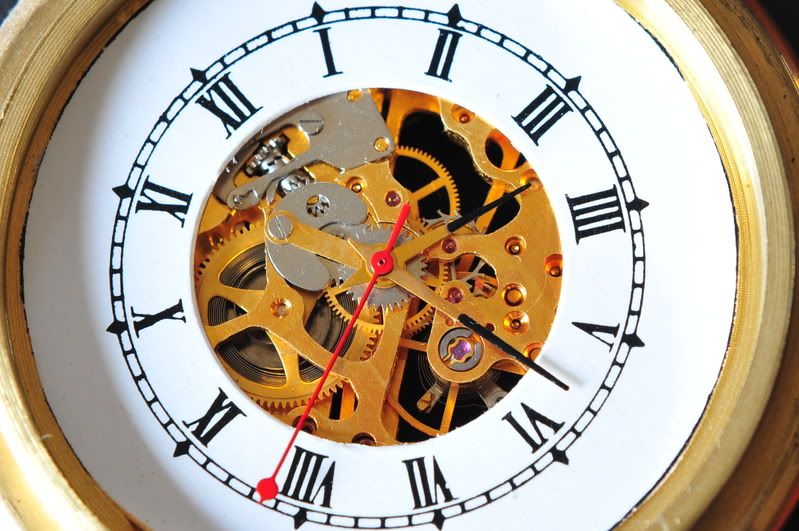

Here is the dial side, but without the filter:
Both were shot in natural light, tripod mounted and in mirror up mode.

Can you give some info about your "close up filter"?
Your shots look very impressive.

Close up filters, are really dioptre lenses which allow you to focus much closer to your subject. This is a big advantage, because the closer you get to the subject, the larger and more detailed the images.
The large picture was taken with the camera tripod mounted with a +3 dioptre mounted. The shot was 1 second @ f13, using available light. It was exposed in 'mirror up' mode.
Here is some more info on 'Close up filters':
http://www.valsphotography.co.uk/information/Lenses_Filters.html
