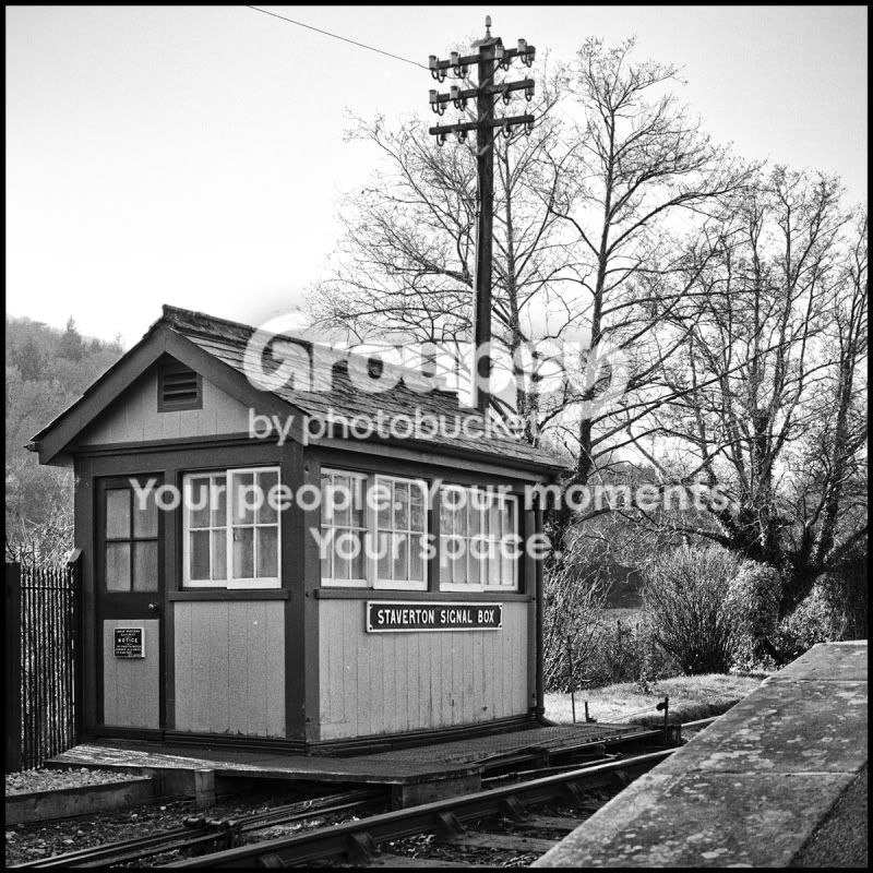

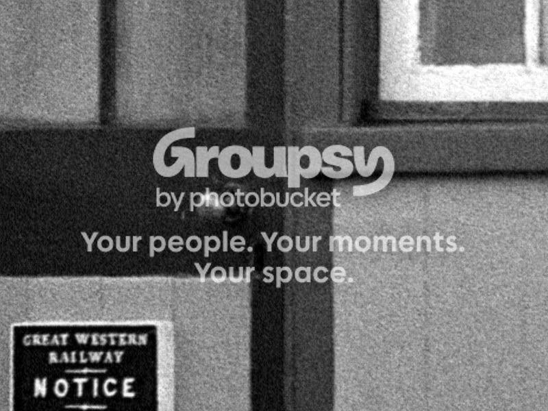

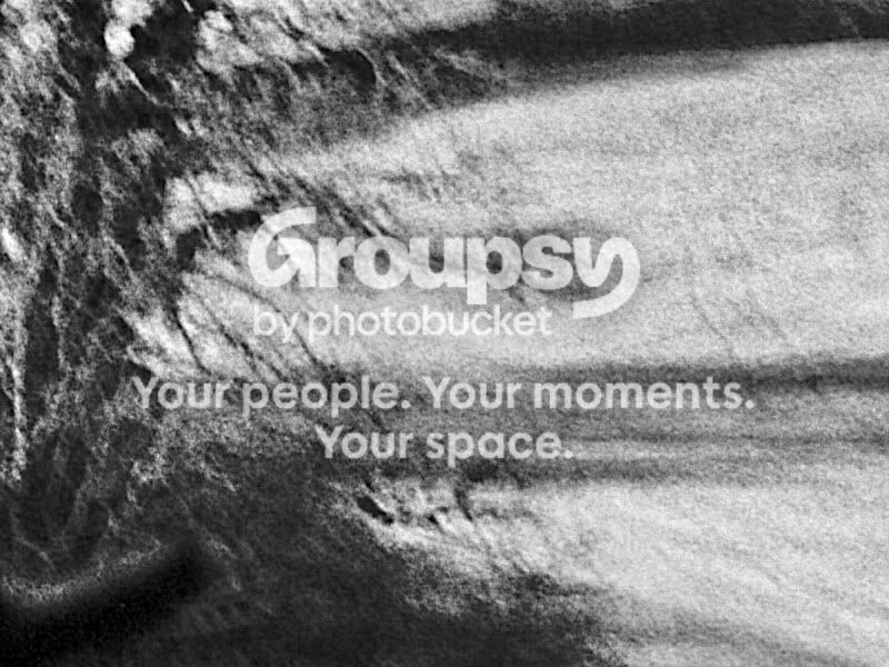

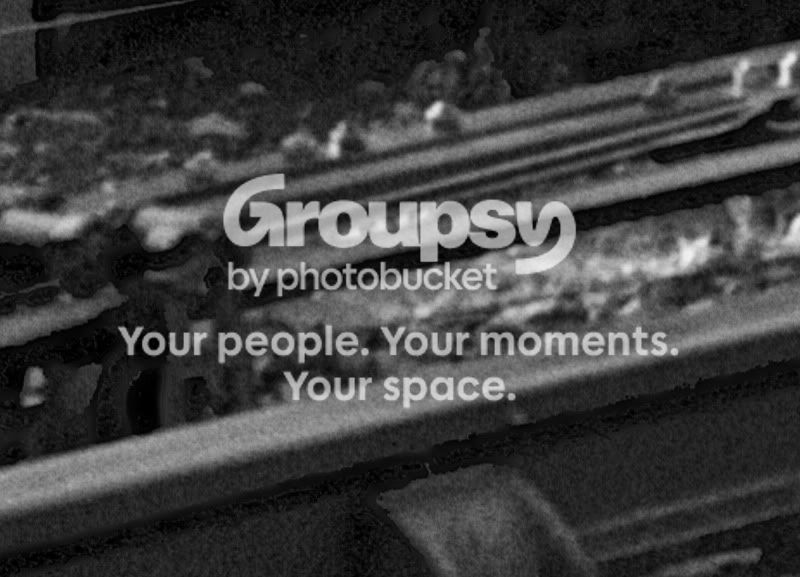

So, what are the results like: They are I believe without any doubt, the best negatives I have ever processed. They have a full range of tones, there is tremendous detail in the shadows, the grain is really well managed and uniform and they look like they would be easy to print, they were certainly easy to scan. We have to remember in all this, the negatives were as is and previously shot at the manufacturers ISO400 light readings were taken with a Weston Euromaster II in reflective mode as I could not get into a position that would allow me to use the invercone, with a developer that is not recommended for use at that dilution (especially with Tri-X), and whilst I changed the LC29’s dilution and development time I only used normal tapwater to make up my dilution, a developer with a Metol base should really be used for this technique(such as Ilford’s Perceptol).
I hope those of you that use film will find my finding’s interesting and may lead to you trying your own experiments in processing techniques, the fun for me is just beginning. My sincere thanks to Barry Thornton.
Full image:
Half Full sized image 6000x6000
100% Crop
100% Crop of shadow detail

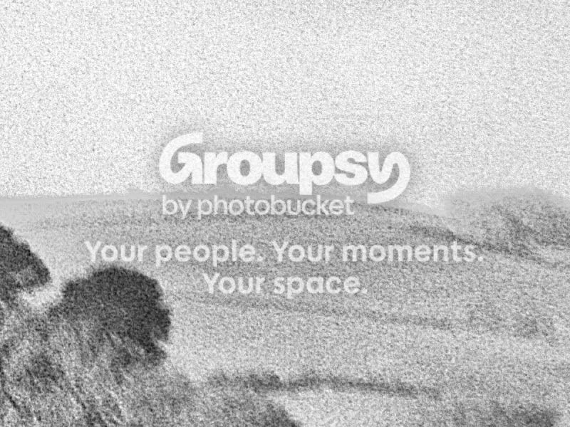

The image below was taken the week before on the same camera, same lens and the same film Tri-X at ISO400 and using my 'old type' processing, the grain is very much more evident especially in the sky area, I will do a 100% crop of the original file later where I think the change will be very much more evident.
These are two 100% crops of the above image before it was played around with in Nik Silver Efex Pro 2 and whilst still at the native 594MB 10190x10190 pixel size, I have added some USM of 80% at 0.8 which is what I would have normally added to that size image, other than that, just as scanned at 4,800dpi with Silverfast 8 on a Epson 750.
