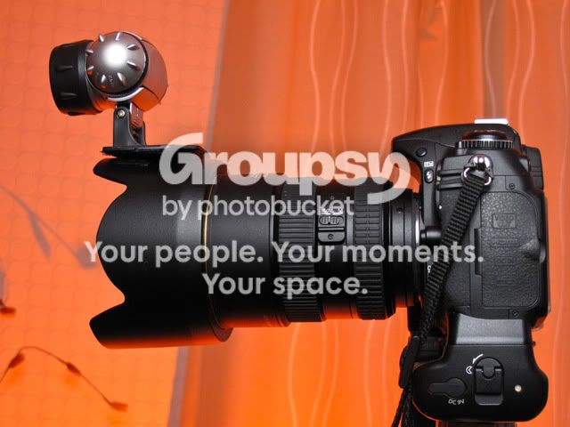

I've got a small led torch (the type that comes on a band for wearing round your head) that attaches with velcro to my lenshood. It's just strong enough to assist af without contributing noticeably to the exposure :thumbs:
Alright, I'm taping a torch to my lens hood, haha.
