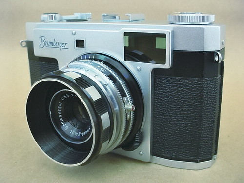

Brumberger

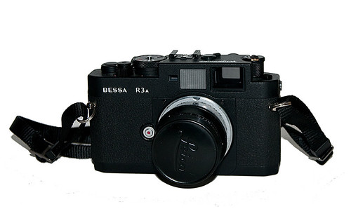

I must admit my favourite picture was taken with a Jupiter 8 lens on my Bessa R
Oh and if I were going to get into rangefinders then the modern voigtlanders are great cameras!
