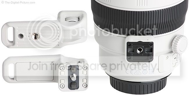

I notice from pictures in reviews that the new lens has two threaded holes in the tripod mount foot. Obviously a good feature to stop horizontal twisting while mounted.
It looks like I may be buying an Arca-Swiss head plate before I magically convert a small piece of plastic into a large lump of carefully crafted Canon glass in March, and so can anyone who already has this lens please tell me the foot length? - I need to decide whether to get a 75mm or 100mm long plate.
Thanks for any help :)

I have the arca swiss P0 ballhead with universal quick release plate 48.
http://www.robertwhite.co.uk/arca-swiss-monoballfix-quick-release-camera-plate-48-universal.html
It works fine with the lens.
I think the actual foot length (before it begins to curve) is about 55mm
....Many Thanks, Marie - That's very helpful :)
I spoke with Robert White this afternoon (they're not far from where I live) and they suggested the 802284 plate because it has two fixing points. They are available in different lengths.
http://www.robertwhite.co.uk/camera...-75-quick-release-camera-plate-75-x-32mm.html

In regard to ARCA plates, for my mkI 100-400 I got the Whimberly plate specifically designed by them for it and a key factor in the choice was that it is shaped with a slight curve that matches the curve on the foot thus only needs a single screw to attach it as the shape is designed to stop twisting.
Robin, that's the wrong kind of A-S plate - it's for the smaller A-S dovetail. The standard dovetail that everybody copies is 38mm wide.
I would take Bob's advice and go for a longer 100mm plate. One of the advantages of the A-S system is you can slide the lens back and forth for optimum balance, but that position changes when you zoom, or attach a heavier camera with battery grip, or just when pointing the lens up or down. I doubt that a longer plate will get in the way at all.
Those custom branded plates are very nice for sure, but I'm really not that fussed. I use all sorts of plates and clamps for my work and last time I bought several of these, priced from £5-10. Quality is excellent! http://www.amazon.co.uk/Eggsnow-Uni..._sbs_ce_2?ie=UTF8&refRID=0HK8W4Q542KKTTN7PF2Y They are technically camera plates rather than lens plates, but I wouldn't hesitate to use them on a lens like the 100-400 (a 600/4 might be different). They are very strong and when done up tight the rubber grips bite into the grooved underside of the lens foot securely, so very unlikely they're going to rotate, especially considering that kind of twisting force doesn't apply to lenses mounted via a collar. But that's just me and you might think differently, just sayin' ;)
Edit: this might come in handy - with a longer A-S plate that overhangs the lens foot, you can drill a 10mm hole in one corner and the Black Rapid spring-clip will fit directly to it.
....Do you have a link or reference # for that Wimberley plate, please?
Renowned wildlife photographer Arthur Morris suggests a Wimberley P-20 plate for the 100-400mm Mk2 but the P-30 is ~100mm: http://www.wexphotographic.com/buy-wimberley-p30-quick-release-plate/p15132

Edit - was quicker to look at and measure the plate it is 98mm long so likely the P30???, yes longer than the foot itself but that does also give you more to grip when handling it. It would be best to email Whimberley to check what plate they advise for the mkII lens foot?
....According to Robert White, who are officially appointed UK dealers for Arca-Swiss and stock their whole range, that #802284 plate which I linked to is the right plate for the Arca-Swiss P0 version I am thinking of getting. I am told that "Arca-Swiss are fed up with having their plates copied" and have revised their head designs accordingly.
....Yes, 100mm plate length is the one I will go for - Thanks :)
