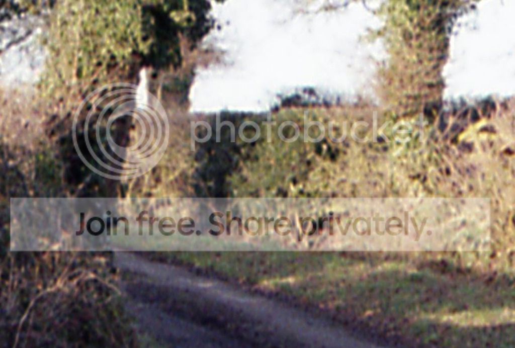

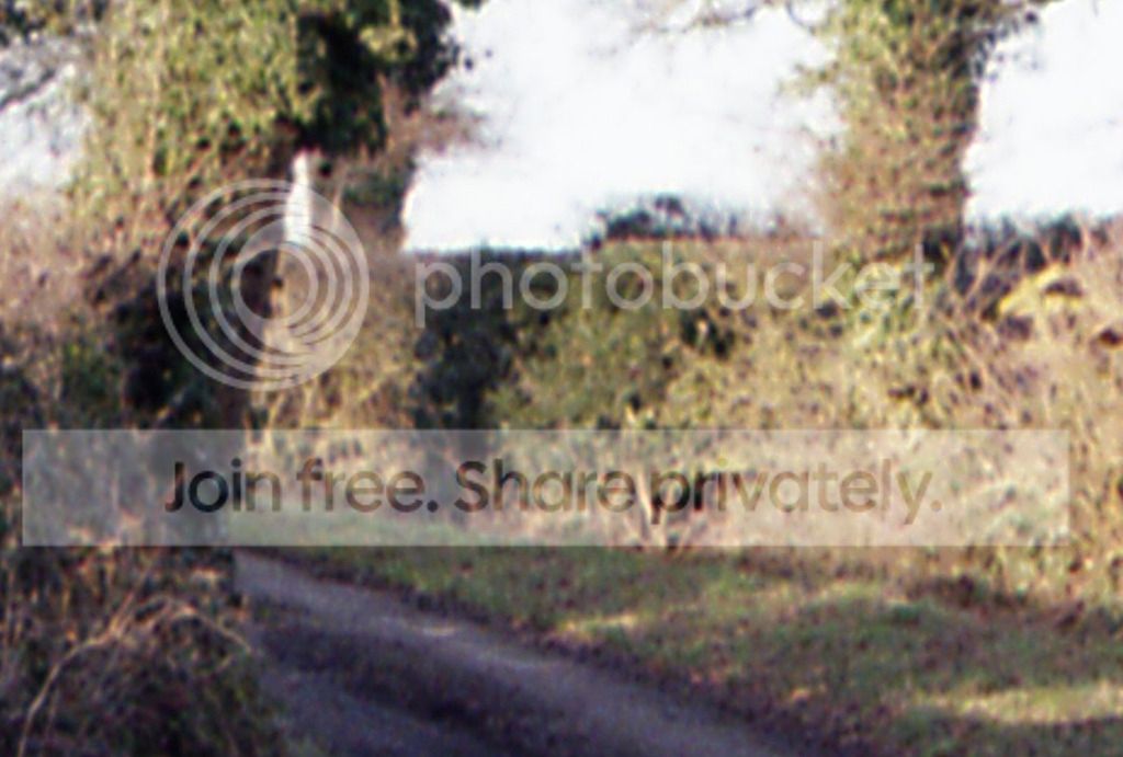

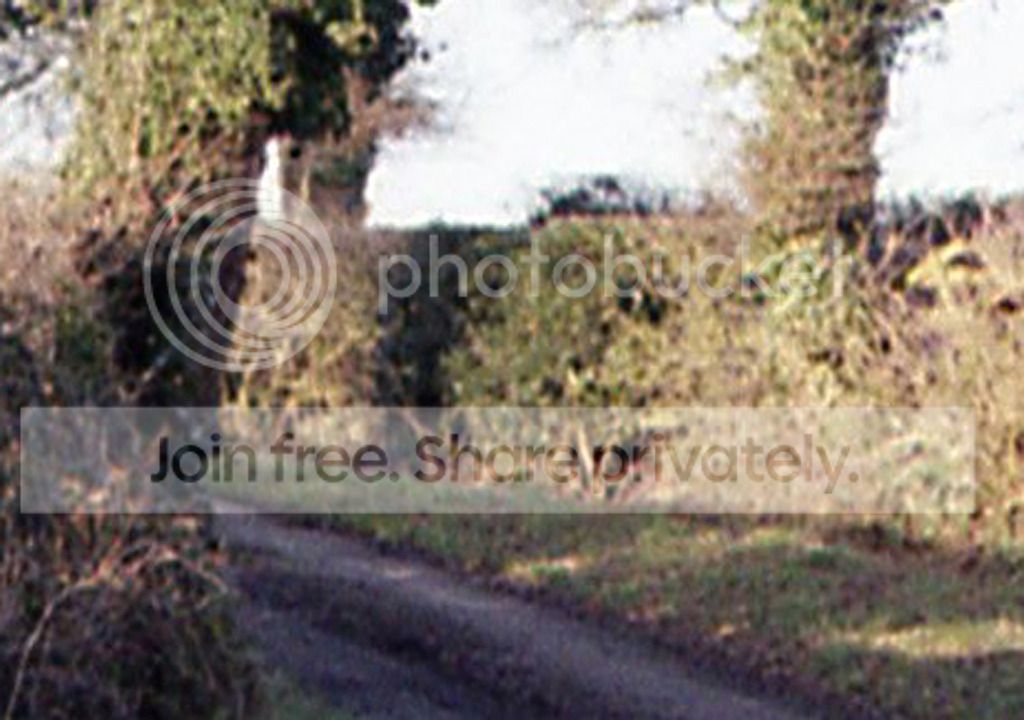

As a quick test, here're three 100% crops of a scan from my V5500. This was shot on Agfa Vista Plus 200 with my Olympus Trip 35. Other than the image (and file) size, I can't see any significant difference in detail when viewed at full resolution in Lightroom - the 4800 scan is just bigger. I CAN see actual digital pixels when viewing the 3200 & 2400 scand at 2:1 enlargement, but only just - and I can see them at 4800 too if I look carefully. Based on this I think I might drop my dpi settings to 2400 (for 35mm at least).
EDIT: As has been pointed out below, this doesn't equate to how shots will look when printed on actual paper. It's just an example of the effect of the dpi settings on the digital file (using my V550 and on this particular shot).
The sizes below refer to the full image, not the cropped section.
4800dpi (4175 x 6607 - approx 27.5mp 157Mb file)
3200dpi (2783 x 4405 - approx 12mp 70Mb file)
2400dpi (2087x3303 pixels - approx 7mp 39Mb file)

As a quick test, here're three 100% crops of a scan from my V5500. This was shot on Agfa Vista Plus 200 with my Olympus Trip 35. Other than the image (and file) size, I can't see any significant difference in detail when viewed at full resolution in Lightroom - the 4800 scan is just bigger. Based on this I think I might drop my dpi settings to 2400 (for 35mm at least).

That's cool! I think I'll do the same then. I presume 2400 will be fine for a4, 8"x12"?

But Nige what's seen on a comuter screen doesn't equate to what you see in print...I've guestimated but never proved (tight wad) that if a shot looks very good @ the longest side e.g 32"on a computer screen then it should look very good in print at 16" (longest side)....anyone going to fork out some cash for a print to prove me wrong :D
That's true, and I don't tend to print much of my stuff so can't say personally. It was more an example of the difference the dpi makes to the shot digitally.
^^THIS^^
Time and time again, I've discussed with people how a pixelated on screen image cannot offer a true representation of what that same image looks like printed out onto photograph paper.
My advice is to stop viewing scanned files at 100%........it's like an obsession to search out imperfections!
If the quality of the image is in the negative then it will print just fine even at 1200 dpi for an A4 print......I have loads of prints of that size, obtained from 35mm negs, which are very very good, even when viewed close up.
