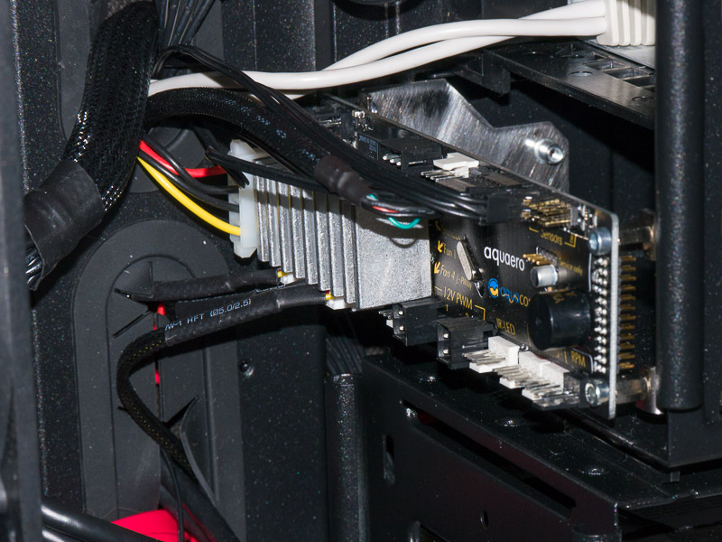

So, I have just transferred everything across, and added in the Aquaero 5 into one of the 5.25" slots.
Firstly, the case is great - except it came with motherboard standoffs that are too short!! I've worked around it using washers and sent an email to Fractal (evidently, others have had the same problem...) and I'm hoping they will send another set out. Secondly, one of the disks is making the case resonate. It wouldn't be too bad, but now it is quieter than before and I can hear the resonance.... I'll sort that tomorrow.

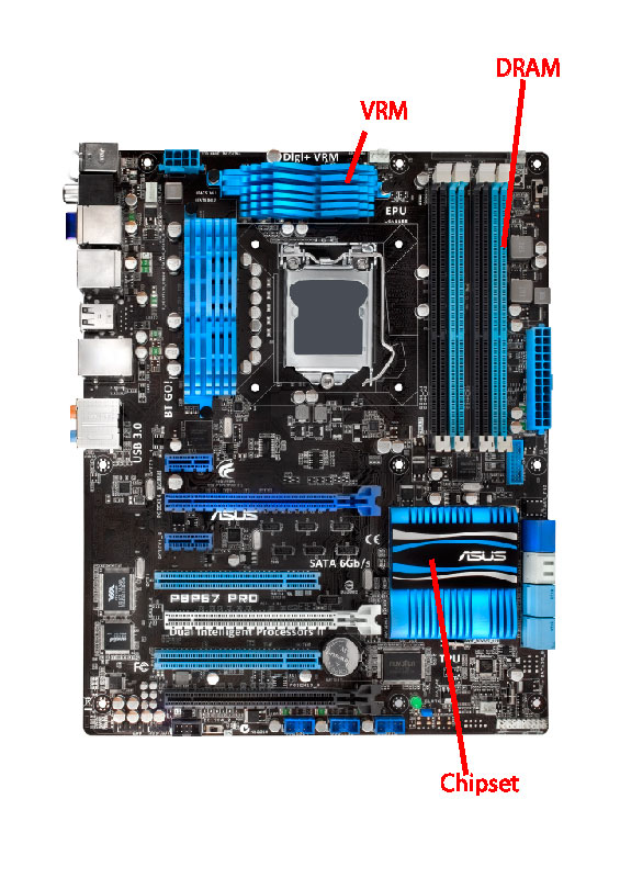

Secondly, I really like the Aquaero. It comes with 4 temp sensors - I've put them as follows:
  • 1 hanging out the back of the case measuring ambient
  • 1 on a HDD enclosure to measure temps (I already do this in s/w but seemed line an interesting thing to do)
  • 1 on the Southbridge chip to check for overheating
  • 1 on the Voltage Reg circuitry to check for overheating

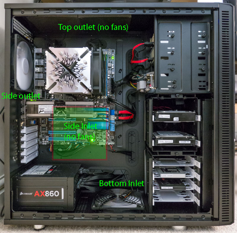

For you Neil...
Case:
And the Aquaero 5 in place at the back of a 5.25" drive tray.

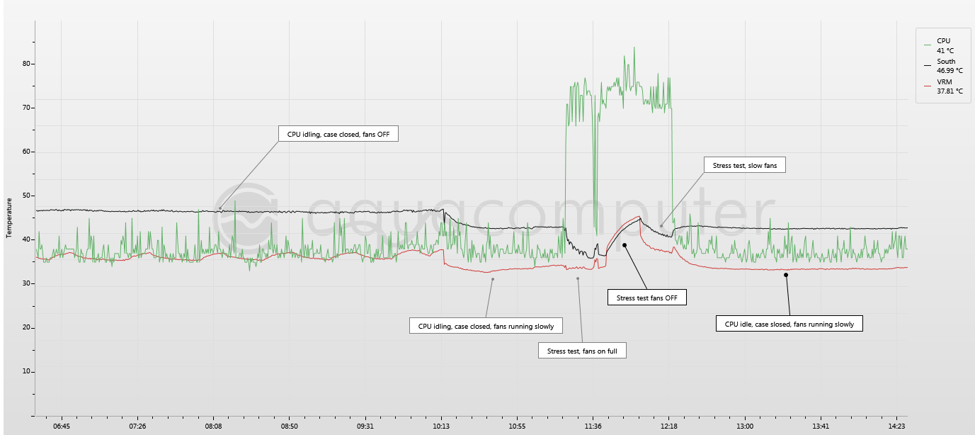

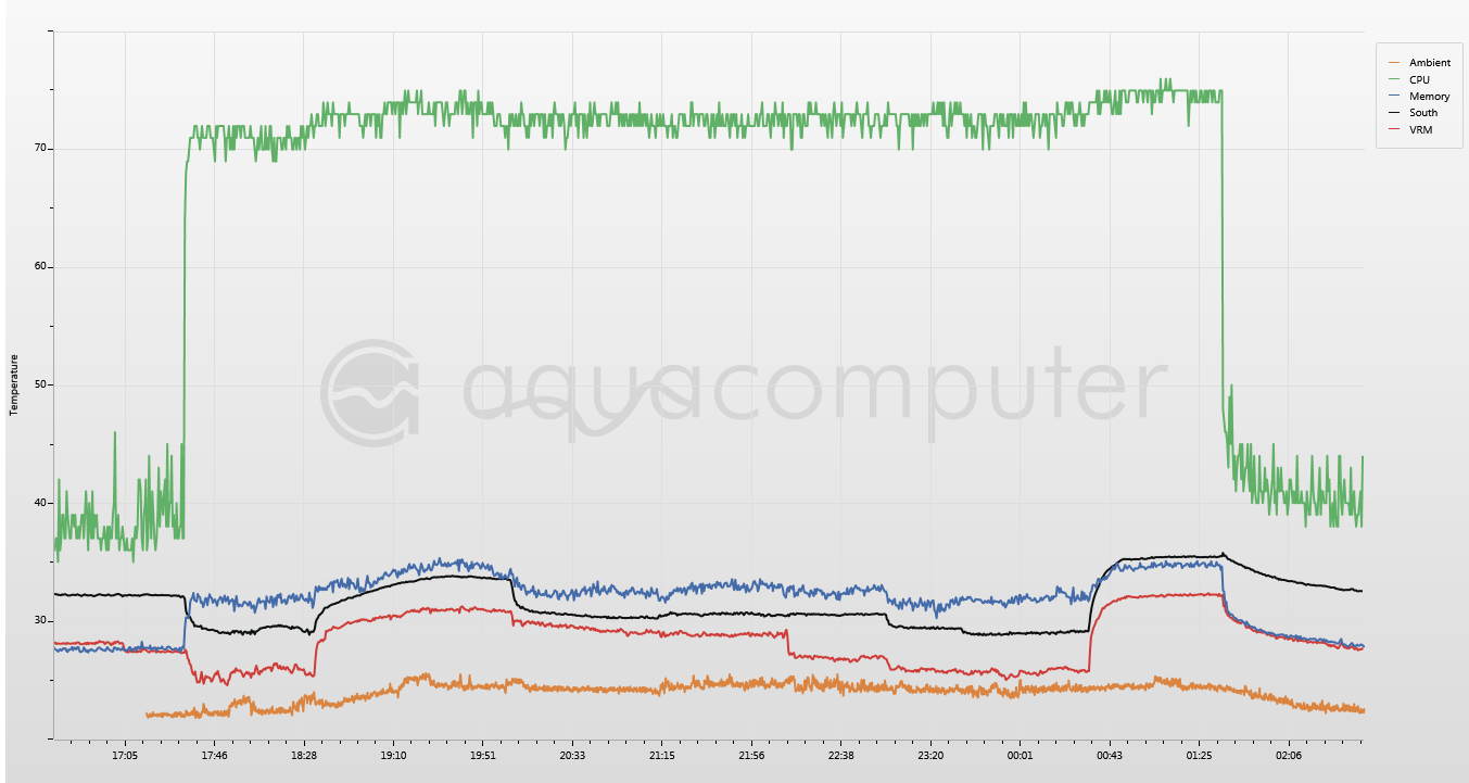

The Aquaero can do data logging and produce graphs like:
PS. The temps are of CPU (green line) chipset (P67 in this case - black line) and CPU voltage regulators (red line). Now testing it with the top two vents open (you can just see them on the picture - squares of foam material) and the door vent unblocked.
hard to tell so you have..
2 inlet fans at the front. 1 exhaust in bottom and 1 exhaust in rear? all controlled from the Aquaero?
1 in the front, but all else correct.
The great thing about the Aquaero is that you can control when the fans come on. Currently, they are all off apart from the CPU fan. The front fan is set to come on when the HDDs reach 35 deg C, the bottom and rear fans are now set to come on gradually when the CPU reaches 55 deg. C (i.e. when actually doing some work). The temps are read out of Open Hardware Monitor as software temps. and you can have up to 8 of them (so the HDD "temp" is actually the highest temp of the 2 HDDs). The control is entirely done by the Aquaero - it's easy to fiddle with the algorithms for input temp to output action (for example, each fan has a max & min voltage so you can mix and match fans and you can also apply a kickstart voltage if the lowest voltage the fan will run at is lower than the voltage needed to start it.

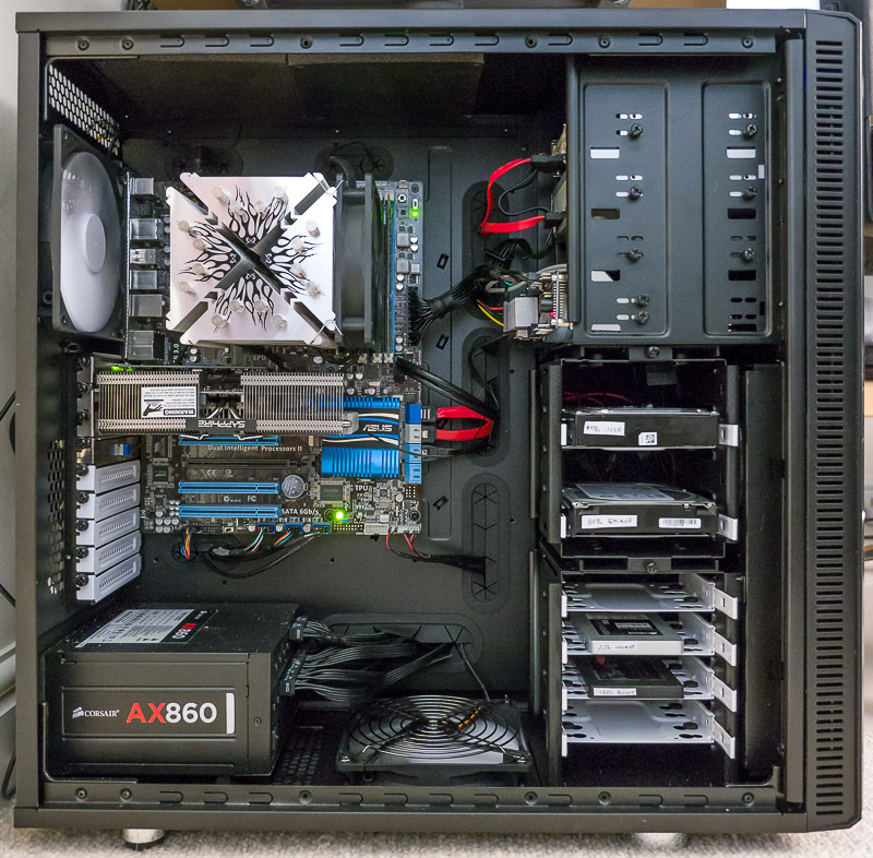

So stage 1 of investigations.
I have:
  • Fractal Define XL R2 case with R2 case fans
  • Aquaero 5, 4 temperature sensors & software
  • i7-2600K @ 4.4GHz (1.296V and 100% stable - it has been running prime95 for 7 hours flat out)
  • Scythe Ninja 3 with slipstream fan
  • Asus P8P67 board
  • Corsair AX860 PSU
  • 16G 1600 memory
  • prime95 run for at least[/i] half an hour at each setting
The case is organised as:
with the removable top two and side vents removed (the top vents are shown fitted in this pic - the side panel is not attached) to allow as much convective cooling as possible
You can see the Aquaero in the back of the bottom 5.25" bay. The 4 temperature sensors are split: 3 for the board, one for ambient which is held away from any of the outlets to get an idea of room ambient. The sensors are on the boards as:

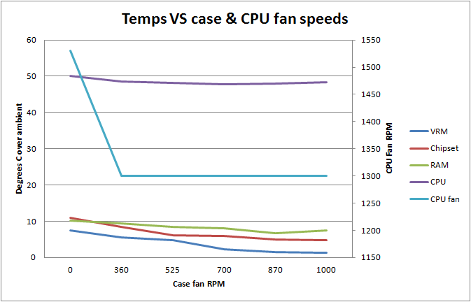

I have run the case fans at a number of constant speeds to see the effect on CPU temperature, VRM temps, chipset temps, memory temps and CPU fan speed (the CPU fan is controlled by the BIOS). The following table shows the various temperatures above ambient and CPU heatsink fan speed for each case fan speed I tried this at. These are average temps (just drawing a horizontal line through all the Aquaero graphs). Given each run of prime was done for >30 mins, they are settled temps.
Plotting this on a graph shows:
My conclusions so far:
  • You can probably get away with no case fans if you have a reasonable heatsink in a well ventilated case. Having said that...
  • A small amount of airflow in a reasonably ventilated case is 95% as efficient as a lot of forced airflow. the worst temp rise I got with no case fans was 11 degrees C above ambient (around 22-25 deg C)
  • Case fan airflow seems to have little to do with how a forced air heatsink performs in a reasonably well ventilated case, beyond just switching the fans on
  • Whilst no forced airflow at all causes the CPU heatsink to work harder, it only has a minor effect on board component temperatures in a reasonably well ventilated case
So... for me, the conclusions of this are quite interesting. Assuming a passive heatsink can cool the CPU at stock (i.e. keep it in the low-mid 70s), the rest of the components on the board will not be too stressed (remember, this testing was done at 4.4GHz and 1.296V). I'm also reasonably confident that with a small amount of airflow (e.g. 350 rpm from the case fans) that a passive cooler will become significantly more efficient (notice the RPM drop when going from convection only to a small amount of airflow) and may well allow for a reasonable overclock with a passive heatsink and inaudible case fans..

PS. Here is the raw temperature outputs - you can see the distinct step changes as I changed the test
  • Green: CPU temps
  • Black: Chipset
  • Red: VRM
  • Blue: Memory
  • Orange: Ambient
Have to say that your VRM temps are really low...heatsinks on mine MOBO are really hot
I will check the sensor placement on the VRM block when I have the cover open. It could be the contact with the heatsink is not good - or it could be that I have a board with good heatsinking!! The VRM heat does go up and down with airflow though :)
Aha... You were right... The gaffa tape holding the sensor on had come off :shrug:
Now doing a new test with case fans switched off - VRM and chipset at mid 40's 30 mins into the test - ambient just over 20 deg C. Will repost results later...

what have you stuck the sensors down with? the cables aren't very long either :|
Gaffa tape. But it is only a temporary job as I'm probably changing motherboards (I'm thinking of not trying to go fully passive, but get something that overclocks quietly and possibly go with something like a Noctua. 99.9% of the time the PC is silent now....
Plenty long enough for me, but then mine is mounted in a really handy place to put the temp sensors down.
You should also install Open Hardware Monitor as that will give you access to the CPU temps (and a few other things too) in the Aquaero via the aquaero service that runs (they are virtual sensors in the sensor box).

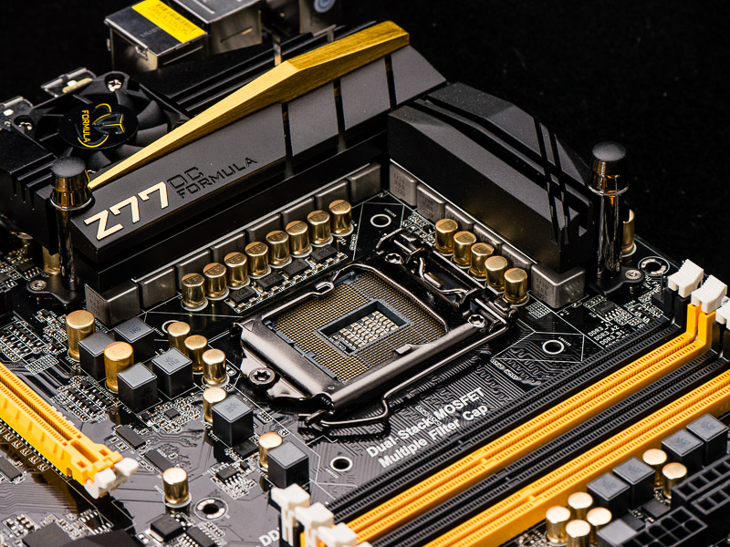

Well... new mobo and cooler ordered...
ASRock OC Formula (want 2x8 graphics lanes so I can get rid of the ATI PoS 7750 graphics card plus some other bits and pieces)

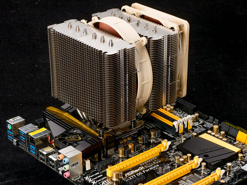

Noctua-NH-D14 2011 + NM-I3 mounting kit (went with the 2011 as it was on offer, plus it has PWM fans!)
I also have some more information on case fans and temps which I will post up later (I'm not in front of the PC all day every day you know ;))

jesus that thing is huge :lol:
You know me and large coolers ;) The mono is over sized too. Will also get a new SSD just in case the is needs a reinstall (going to see if a repair will do it)

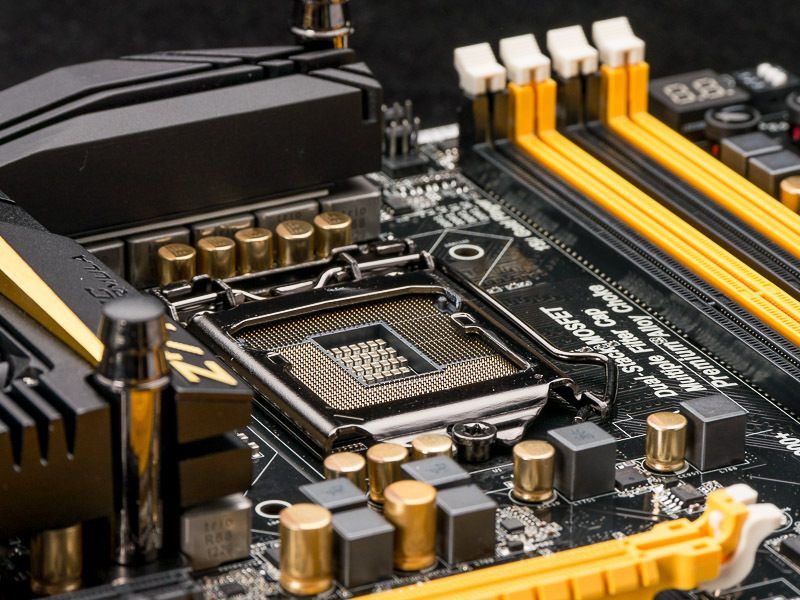

And the bits have arrived. I feel the need to spend half an hour in the garage checking my studio lighting still works ;)

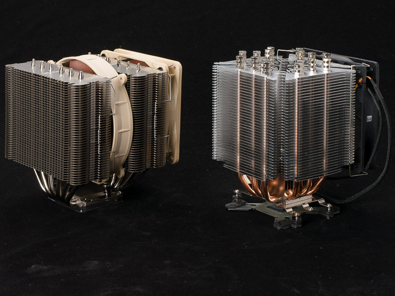

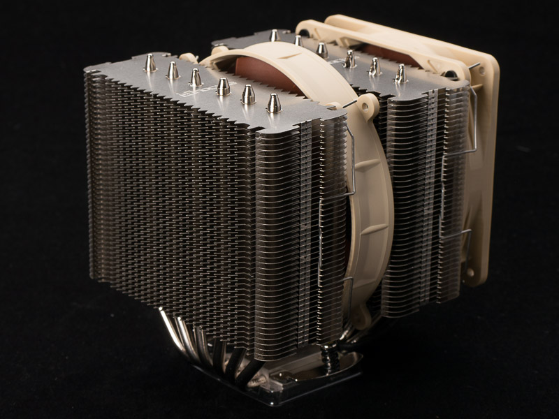

A Noctua NH-D14-2011
... against a Scythe Ninja 3
Wot... no chip
Still no chip
This is what it will look like mounted....
