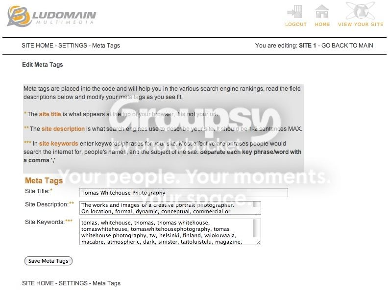

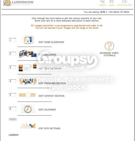

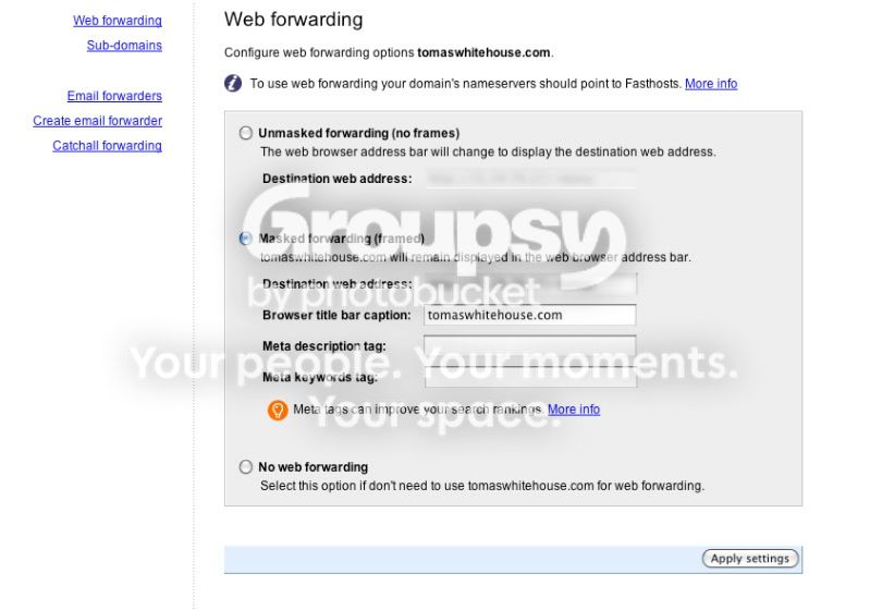

Here are the things that I have options with (other than editing the php index):
My fasthosts control panel
my site control panel
Since the last time I posted, I had filled in both panels with the same data, google re-cached my site on the 27th so I then scrubbed all the data from the fasthosts panel to see if this will make a difference after being advised not to use the same keywords twice.

Put your name in the site description.
You've gone overboard with the keywords and haven't nearly enough human-readable text on the page. Sell yourself! If necessary, link to an About page, but place all those keywords in a few paragraphs of text. Use www.useit.com for some Web-writing guidelines.
Text of the same colour as the background is the cheat that's frowned upon. You can hide a link with CSS and it'll still get spidered.
The page needs validating.
I like that, sounds nice and simple :thumbs: Thanks so much for replying mate, I really appreciate the help :)
When you say human readable, do you mean the Finnish keywords? The Finnish stuff is more important than the English y'see. apologies if I'm way off.

Don't use web forwarding from your domain- google probably doesn't like this

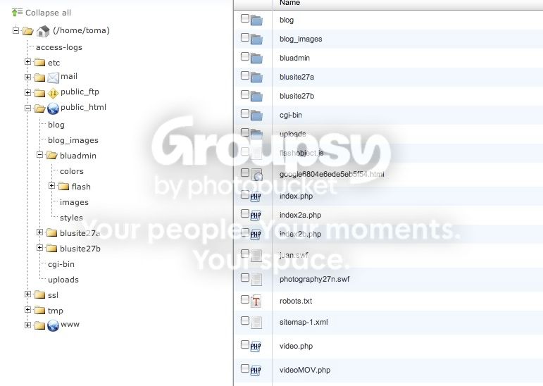

My site or rather the control over my site is similar to signing into an online account, whether it's email, banking or similar: I wanted a simple to update site that required no coding, seems I made a bad move.
and then the cpanelx filemanager:
I'm not sure but would making changes to it outside of the available controls involve having some kind of flash editing software?
If editing the the index pages (.php) is all that is needed then I can do this (just about) by downloading the files and altering it and re-uploading.
If it doesn't involve editing the index pages then it seems my hands are tied. I have no clue how to or if it's advisable or even possible to edit the bludomain template.

Hmmm, this is where I get a little more confused and must seem very stupid to those more in the know.
Where do I input the data?
The two images provided in my first post are the only places other than the .php so I think this could be where the problem originates, it doesn't seem like I have anywhere to change or rectify this to make it better.

Also you have two of the main pages being called /index2a.php & /index2b.php ...by the php code.
Change those to useful photographic website page names.
Hmm, interesting, could there be any problems in changing the filenames? Would it effect the .swf files at all?

So the alternative would be to have bludomain do my web forwarding?
Depends if they support it. You could point the A Record of the domain directly at the bludomain server- this would be preferable.

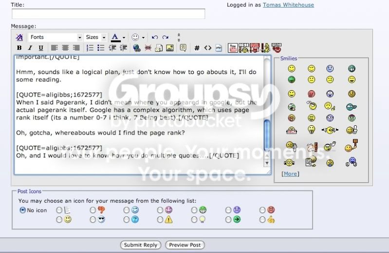

When I said Pagerank, I didn't mean where you appeared in google, but the actual pagerank itself. Google has a complex algorithm, which uses page rank itself (its a number 0-7 i think, 7 Being best).
Oh, and I would love to know how you do multiple quotes....
Your keywords we can call machine-readable. They're really for the benefit of Google etc. They should match the content that we mere mortals can read on your page (the human-readable content), otherwise Google may think you're spamming. Anything on the page that's there to be read by your visitors is the the human-readable content.
An About page (or any other with plenty of text) should be linked from all other pages. As well as helping to get you found, you should use it to answer any pre-sales queries that are likely to arise, including prices (you're OK on that score).
They do support it but I don't think I'd be comfortable with it to be fair, I doubt that I'll be using bludomain (the web designer) next year.
Oh, gotcha, whereabouts would I find the page rank?
Make sure you have the opening quote code, then the text you wish to quote, followed by the closing quote code, seen here:

.... other stuff... I'm not sure but would making changes to it outside of the available controls involve having some kind of flash editing software? If editing the the index pages (.php) is all that is needed then I can do this (just about) by downloading the files and altering it and re-uploading. If it doesn't involve editing the index pages then it seems my hands are tied. I have no clue how to or if it's advisable or even possible to edit the bludomain template.
Yes I'm not sure either, unless there’s a editing entrance of some sort, I think your stuffed with editing the flash code. Probably the best solution, as suggested, is to make a new 'about you' page and link it as obviously as you can from those two flash coded pages. (that will help google understand how to log your site )
On the editing front, well just about anything html can be edited its the access that the problem. I'm guessing your not using an ftp loader of any sort (search for cute FTP) File transfer protocol….try ‘free FTP loader’ or something.
Once you gain access of your actual files you can edit what you like, obviously you need to be very careful not to edit any structure, flash or database coding etc, but you should be able to find ways to add words/text, change file names and even change the style a little.
Editing the php page names should be easy once you get access..
You need to understand two things. First your pages are built by the php code as the page is called for by the viewer... so the php code collates what it is instructed to collate for each page when the page is called. The whole pages are not built individually before ...only each necessary section is built, and the sections are collated to be shown depending on which page the viewer clicks on.
So...you need to change the index2b.php's in two places.(and again for index2a.php) One on a main index page which calls for the php sections to be collated (called header sometimes, because its often at the top of all pages called) .., and the other change the two actual php page sections that are being called for.(the file names being called)... in your case the flash based pages.
Its a nice site Tom, I don't think you should be so quick to move on it just needs a little polishing ...inevitably with any site, paid for or built oneself there’s a million ways to improve it. Some of the paid ones can be atrocious yet still cost a fortune so you may just find yourself in the same place again which ever direction you choose I feel..
Both php, and html are mark up languages (Think that labels right) rather than actual coding so get yourself a FTP up-loader and some sort of html editor and have a look at your pages ... there just compositions suspended with the code ...bit like photography. :D
Unfortunately you’ll have to save and load any php changes back onto your hosting provider via your ftp tool, (always back up your good pages before editing) before you can see if the changes have worked or messed up.
Bit confusing at first but after a play or three you should find yourself getting something back.
Good luck, hope that’s not too flawed advice. :thumbs:
