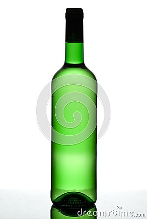

"Shiny" isn't an issue with backlighting... but opacity is. If you backlight glass you get a bright(er) center and darker edges (as seen in the example Kodiak posted). By backlighting thru a cutout you can combine that lighting with dark field lighting (from behind/sides).
Here's an example of a backlit bottle.
If it had been backlit thru a cutout in a black BG all you would see is the bottle center and all of the darker parts would tend to get lost. So it then needs to be additionally lit to pull up/retain the edges/fill. In this example, if it were on black I would reduce the backlighting ratio and use the "dark field" method of wrapping some light around the edges at a higher ratio.
That's essentially what I did here... I used gold reflectors to backlight the bottle/glass using the dark field lighting as primary.
