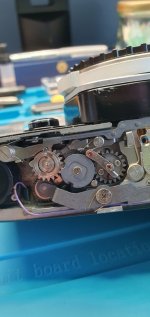

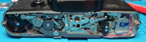

Well I had some time on my hands today, so the baseplate was removed, and sure enough the idler gear was way out of place, but there must be a reason for it to be so out of sync, after taking out the idler gear and spring out, I started looking for the problem.
Turned out the gear that tensions the shutter curtains was too tight, a quick clean with Isopropyl alcohol, and once that had dried, I applied a few drops of watch makers oil, and left it to soak in.
Thankfully after everything was put back together, everything works, including the self timer, time to start on the light seals.20251210_122903.jpg
Idler gear out of Sync
Idler gear removed
All put back together
