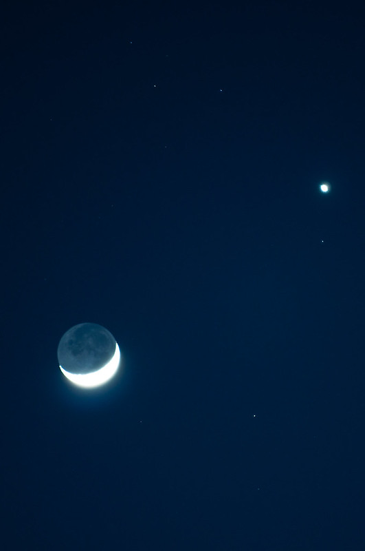

cagey-great photos i especially like the 3rd of the moon thats awsume i definetely want to give this a go i need a longer lens though, 105mm is the longest i have :( thanks, dan.
Just checked the exif again, and I didn't use the TC, thought I had. But I was in DX mode on the D800. It is still cropped down a fair amount. I'll have to try again next clear moon, with the TC next time :)
I think unless you have a 400mm+ lens you will always have to crop moon images. It can seem big in the sky, until you shoot it and realise how hard to fill the frame it is.

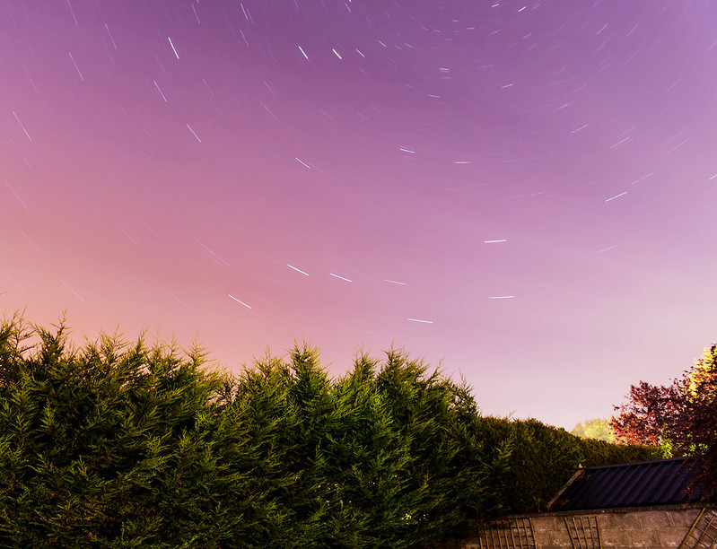

Here's my home town....
To get a long, single exposure with no light pollution, you're looking for somewhere that's at least 7 on that scale. In the UK... that's pretty much parts of rural north Wales, Galloway, or the highlands.
You can process it out to a degree, but that's not the issue. The light pollution in urban areas as brighter than the objects you're trying to capture, so it's impossible,
