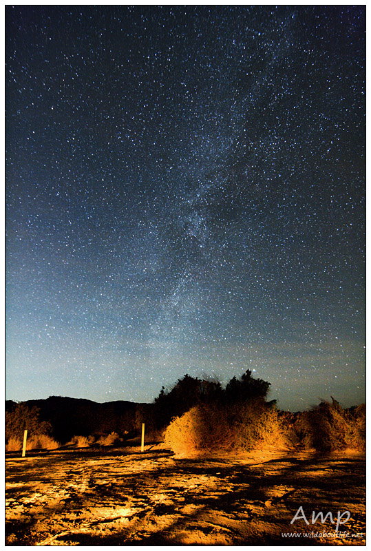

At the moment I have tried wit 34 shots I took in deat valley, problem is it runs ouut of memory (RAM I assume) before it's finished... :(

Amp34, I used to do this with only 1Gb of RAM. I stacked 154 light frames, 15 darks, 15 flats and 15 flats darks, all 450d RAW files (some 15Mb each). DSS is pretty good at memory management. is it possible you hit an issue with disk space as the stack process will use a lot of space for temporary files.
I was (am) using 34 tiffs/jpegs (tried both, both times came up with a memory problem) and told it to keep temporary files on a disk with 500GB free so I don't get it either, unless it's still trying to store it in C: which has only about 5GB free. It doens;t come up with not enough memory at the beginning, which it did before i switched to the other drive so I don't know. I'm currently running it with 24 frames, I'll go up in a second and see how it's going.
Using 2GB of RAM BTW, I managed to do the same thing before with the RAW files but it came out rubbish, which is why i am trying with pre processed tiffs.
Did it just look a bit rubbish on screen ? If so, save with the changes embedded but not applied. The DSS adjustments take some getting used to and often look somewhat werid. If you've converted the RAW's to TIF's I guess the file sizes are significantly bigger so it may well be a memory issue.
The Tiffs's are 28.8Mb each so yeah they are quite a bit bigger than the RAW's but the Jpegs are only about 12, so hardly any different. It ran out of memory again, so i've chopped off another 14 light frames, leaving 5 dark frames and 10 light frames, lets see if it can come with that.
It's very odd, as I said it coped easily before, I may have the tiff lying around somewhere, I may have another look at it.
I don't think it was too much different to yours, but maybe I was expecting a lot more visible milky way due to seeing other shots using DSS.
Once DSS has finished, then you need to stretch the histogram with curves to pull out the detail and real faint stars that are in the image.
Right, i've just got back and looked at it and.... no memory message this time, but all the image cam out as is a load of vertical lines on the page, definately not stars! :LOL: I'll see if I can find the original star shot.
It's trying to save the shot at the moment, i think I may have broken it...
Might give DSS a reinstall before I have another go. :LOL:
Think I may have found a possible solution. If you set it to anything other than "Average" instead of taking up just 106mb it will take up 8.7 GB, still doesn't explain why it ran out of memory...
Trying with the RAW's again to see what happens now, just another 15 mins to go...
EDIT 2: well it got right to the end and bam, out of memory...

Reinstalled on the 500GB drive and ran it again, and it works, just waiting for it to load all the image up before I have a play again.
Right: finally...
Maybe a little over the top with the curves?

That's a lovely shot of the Milky Way Amp. That APOD shot looks like it was done with an All Sky Camera rig (Some form of curved mirror)
