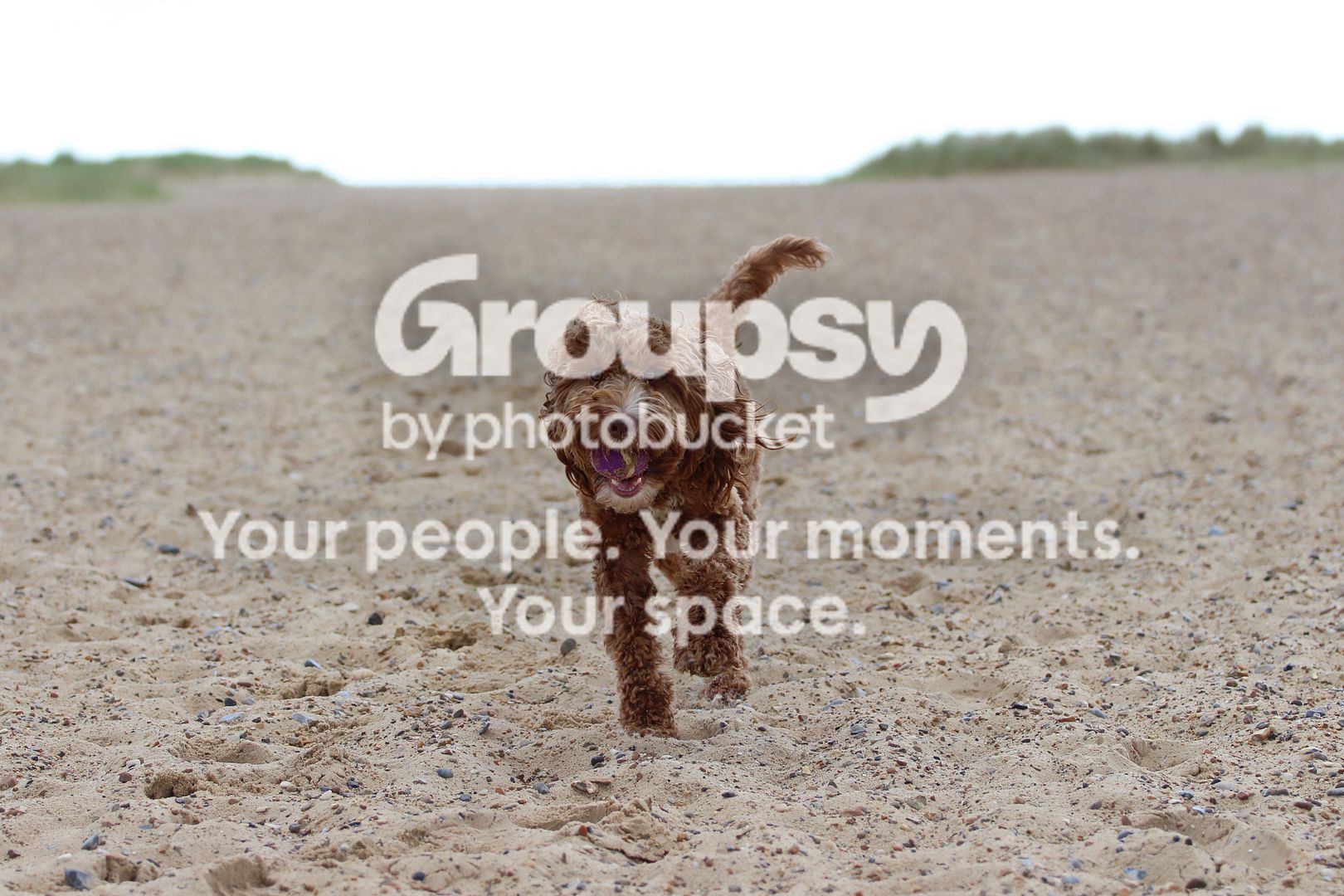

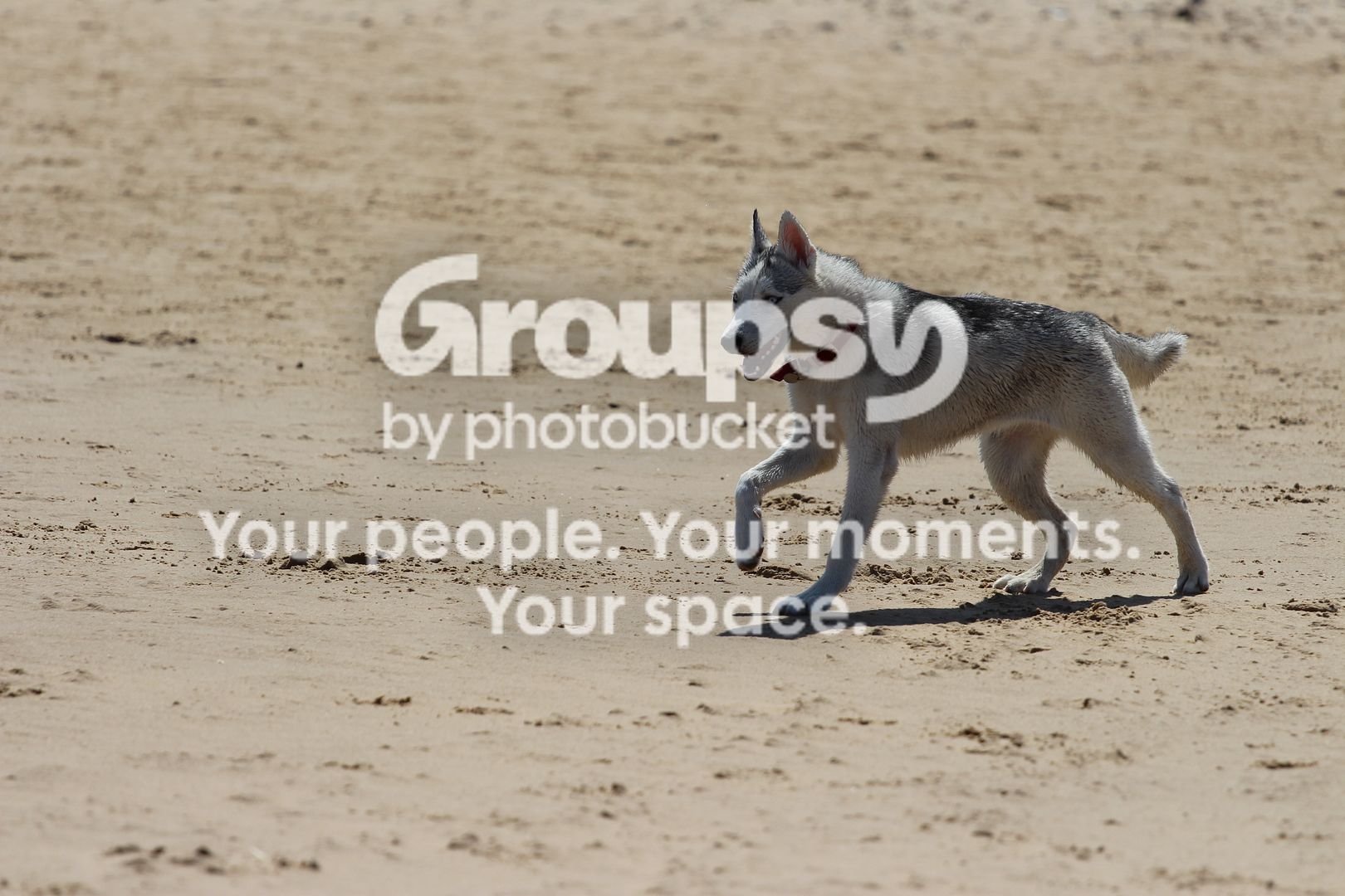

Say for instance this (this would be one of the worst ones I have, they're not all this bad I promise! Haha).
I have found the data for that
F11
Iso 100
Shutter speed value? 7.37
Focal length 75
Exposure programme AV
Dark, no detail.
F5.6
Iso 100
Shutter speed value 10.37
Focal length 70
Exposure programme shutter priority.

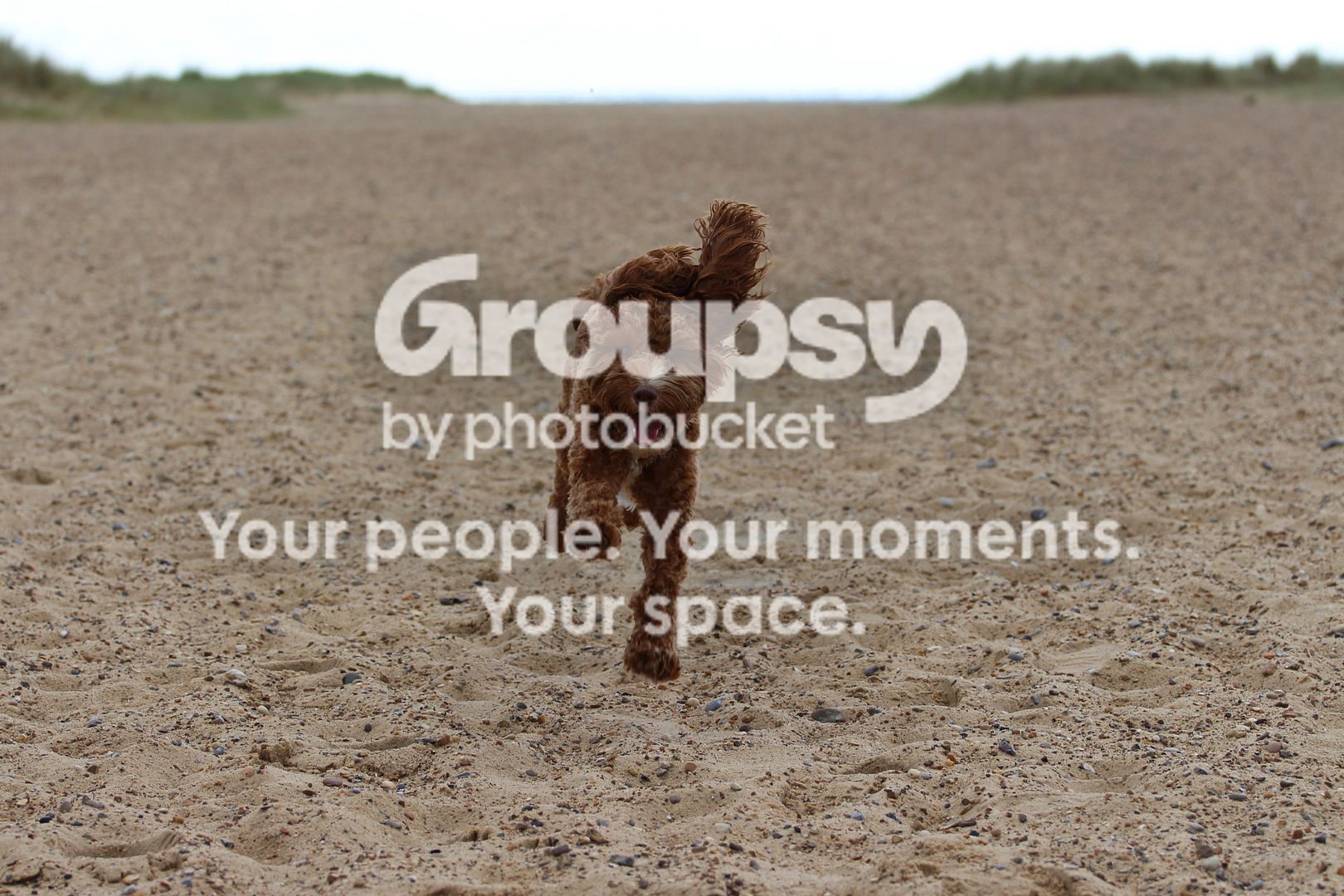

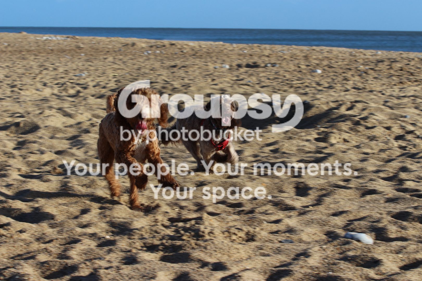

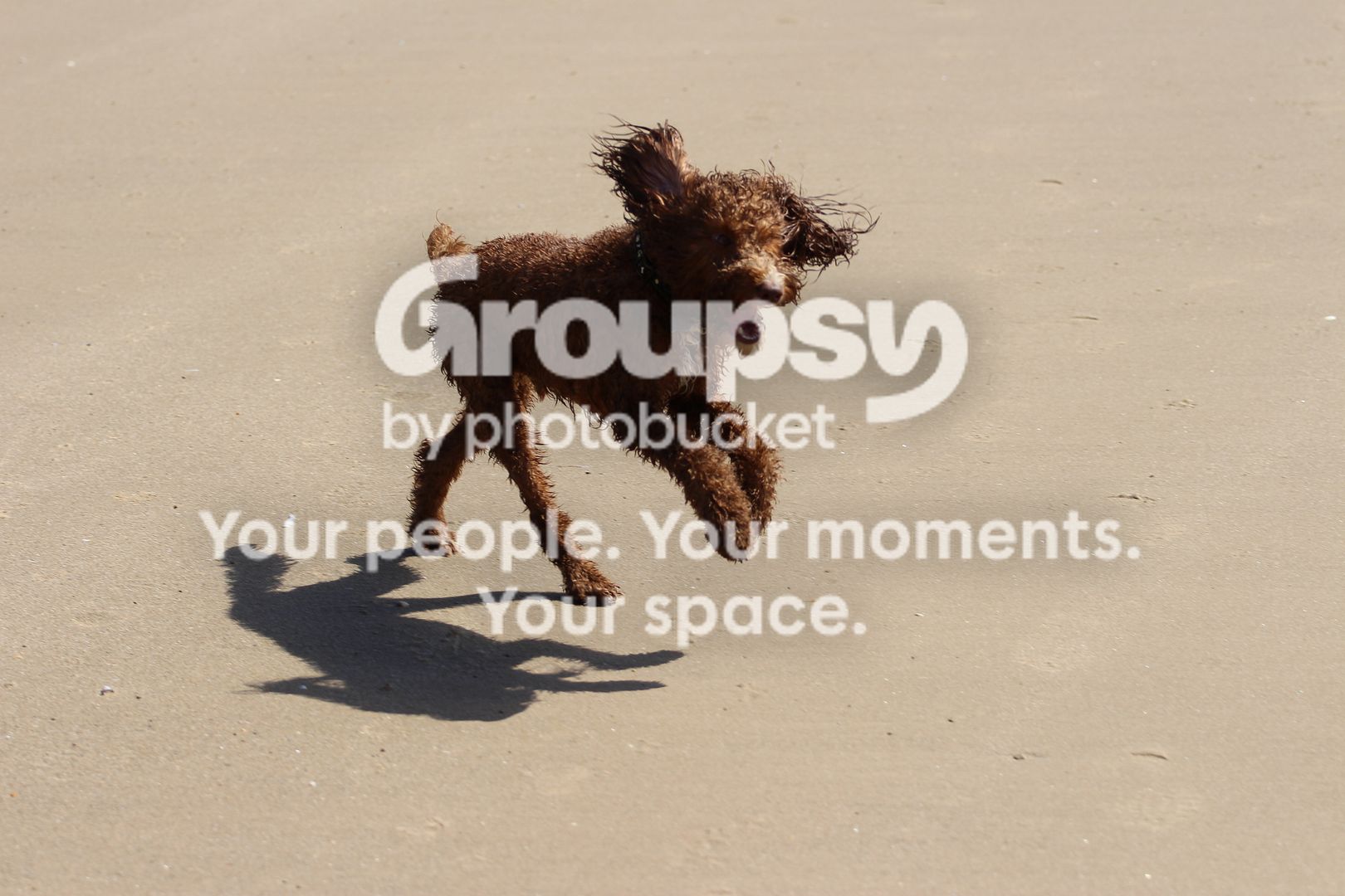

Like I mentioned before, I get a lot of photos I like, I would just like to learn what I could be doing wrong at times rather than just shooting in different modes and hoping I get some nice shots.
I'll do another post with a few I like.
F4
1/800
70mm focal length
Auto?
A bit dark but came out after editing in photoshop on iPad. This is the original.

Pic 1 was shot at
Canon EOS 700D | 70mm F11 1/160 ISO100 | 2016:09:04 08:12:47
Pic 2 was
Canon EOS 700D | 84mm F4 1/1250 ISO100 | 2016:07:17 11:34:25

I have an EXIF viewer on Google Chrome. I can see the EXIF on the photos that you've just put up ;)
This first one has a shutter speed of just 1/160, which is why it's blurry. The F11 aperture has caused this with the ISO only being 100. Open the aperture up to as fast as it can go. For my dogs on the move I stay above 1/800.
The second one is dark because the sun is on the other side of him, so you've got the shadow side. Standing with the sun over your shoulder would've worked here (y)
see the screen shot of your image of the husky (if that is correct) all the red squares are your focus points...
All those are giving you exposure problems due to the sand, as a start point try a stop of + exp compensation. (Maybe more- check the histogram.
Pick your focus point, the camera has to work hard trying to refocus and decide what to focus on.
As above a faster shutter speed will help, and if you want 'interesting' rather than 'OK' images, think about the light, contrasty light will give you punchy images, but you need to consider its direction. Shadows are vital to create form.
Put iso into auto (set an upper limit if you feel the need, say 1600), noise is improbable, blur isn't. Af is better set to AI servo, i find setting the mode wheel to Tv is better than Av (but not everyone does). I use centre point focus, i find that sometimes the camera gets a bit confused as to what to focus on when all points are used (not so bad when pointing the camera at a bird in the sky).

Info from the first image, problem has been the shutter
Canon
Canon EOS 700D
1024x683
Y, Cb, Cr, -
EOS High-end
2016:09:04 08:12:47
2016:09:04 08:12:47
2016:09:04 08:12:47
1/160"
F11.0
F4
0.019 mm
23.49 m
Aperture-priority AE
Evaluative
Off, Did not fire
100
Auto
70.0 mm
70.0 mm (35 mm equivalent: 110.9 mm)
sRGB
Normal
Normal
3
Canon EF 70-200mm f/4L
