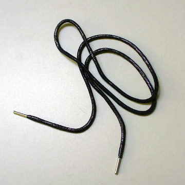

Use one of these?
I've got some of this on the way...
I did think about using a P&S camera wrist strap as those things seem damn tough. Another abundant option is a Nintendo Wii remote strap - they're given some abuse.
Sure that's long enough?
