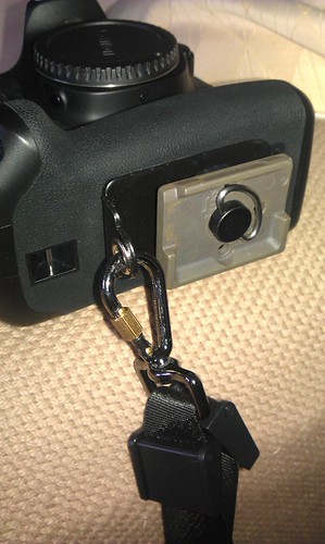

I got my Q-Strap today and then attached a Manfrotto QR plate to see if it would work.
They are not for budging unless I use a LOT of force. The back ups mentioned here look worthwhile.

Q-Strap with Manfrotto QR plate. by Dougster8000, on Flickr

Doug - That tripod QR plate screw there? Is that the one that came with the manfrotto QR plate? If so, are you happy that enough of the screw thread is still able to screw into the camera's tripod mount (whhat with the addition of the q-strap plate)?

It looks like it is the standard plate thread Dougsters used. I have an identical one. It has 5mm of thread, the plate is about 3mm thick..... Dougster I think you're mad.... You'd be better off just using the plates own hoop or getting a longer centre bolt.

The tripod QR plate isn't taking any weight.
It screws onto the L=Plate

No but just two (ish) millimeters of bolt thread are holding the entire weight when it's upside down by your side. It wouldn't take many turns for it to undo itself either.

Sorry Doug. I think I got the digression started - I couldn't see the gap between the L plate and the tripod QR plate. They looked flush and so I thought you'd removed the screw that came with the Q-strap and were using the manfrotto screw alone.
OHHHHH I see now. My apologies, it's not mad, it is perfectly sane.... sorry for my stupidity Dougster

Updated Q-Strap angle and temp back up cord.
I hope to be getting a 70-200 f2.8 USM II soon so I'll be looking at the set up pictured earlier in this thread.
