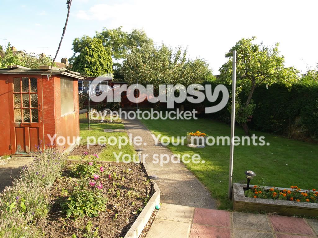

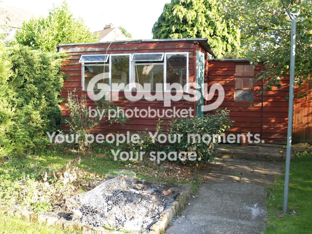

I'm making plans for a outdoor studio, I've just measured up the garden and if we put it across the bottom we have a space of
28ft wide x 10ft deep (comes up to an apple tree)
It will double up as a summer house, does anyone have any advice on the build?
Is the space good enough? we could make it deeper if we got rid of the apple tree but that would take some reasoning with Louise.
Any advice, things you would consider if making a studio building from scratch?
Height may be a problem as you need as much as possible.

I think I might just go as high as I can within regulations, and make the most of it.
Good ceiling height is nice for sure, but you can usually get by well enough with normal room height for most things, assuming it's portraits etc. I'd be more concerned about the width - 10ft isn't much, bearing in mind a standard background roll is 9ft and you need at least a few feet either side of that.
Looks like we'd have to take down this tree, not only because of the 10foot width limit - 1 meter would need to be a gap to the boundary! so it'd be even less..
Be carefull to consult building control, if you go over 15 sq mt floor area they will get involved. Humungus new soakaways and all sorts of over the top crap at anything over that size.
I hate to be the bearer of bad news, but that's a mature apple tree. You need to check with the local council in case it has any TPOs or conservation areas in place before you chop it down.
That is not strictly correct. The regulations state the following:
If the floor area of the building is between 15 square metres and 30 square metres, you will not normally be required to apply for building regulations approval providing that the building contains NO sleeping accommodation and is either at least one metre from any boundary or it is constructed of substantially non-combustible materials.
So in essence if the distance to the properties boundaries are greater than one metre it can be built of timber with a floor area of up to 30 square metres without BR approval. If it is within one metre of any boundary then if it is constructed of brick/block or other similar material it will also not require BR approval up to 30 square metres.
It is important to note that ANY building work must comply with the appropriate regulations, whether approval (planning or building regs) is required or not.
To the OP you can build up to an eaves height of 2.5 metres - if you put a pitched roof on you can go to a max height of 4 metres at the apex (it has to be a dual pitch btw, not a sloping roof) - all other roof types have a max height of 3 metres.
Whatever flooring you use, make sure you insulate under it too as heat is lost through the floor. Underfloor heating is not cost effective in occasional use buildings, much better to look at other forms if possible. As stated insulation is key and it is difficult to have too much. It is better to use the kingspan/celotex type insulation than polystyrene type too, both in terms of efficiency and safety.
You may find this link useful http://www.planningportal.gov.uk/permission/commonprojects/outbuildings/
Great info thanks, and I'll look into the tree thing..
just got off the phone - no TPO! great :) although Fiancée doesn't want it gone..
But I don't want a summer house if I can't use it for photography either ;) so therein lies the dilemma
