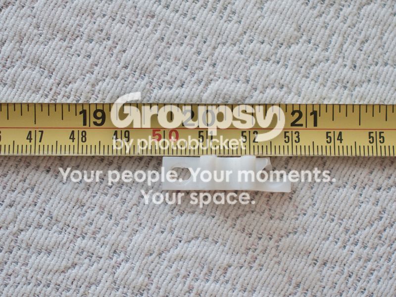

This may be a long shot but here goes...

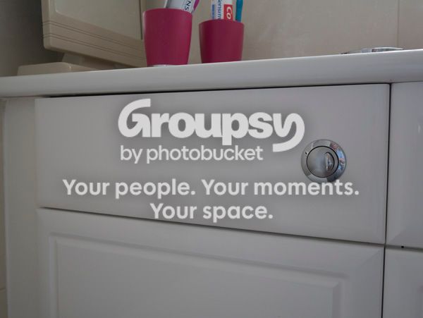

Our toilet flush push button is mounted on a panel which was held in place by four little plastic clips each screwed to the panel with two screws. These clips each clasp onto a plastic post and thus hold the panel in place. Unfortunately all four clips have mysteriously broken and the panel has fallen off. I've taken one of the clips off and taken it to B&Q but they've never seen anything like it and of course typing "plastic clip" into Google brings up everything from sun glasses to pictures of cats but not what I want.
I hope that knowing what it's called will help, so does anyone know?

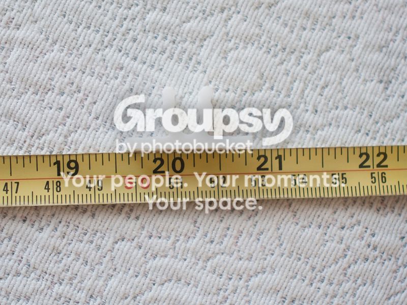

The thing itself is about 30mm long and the hole for the post is 7 or 8mm.
Does anyone know what this is called and where I can buy some?
That looks like a miniature pipe clip. Not sure where you'd find replacements though. A temporary fix (that could last ages) that I would try would be to use washers under the screw heads and no not tighten the screws too much. Failing that, using mirror screws in the corners of the panel shouldn't be too unpleasing on the eyes.

Ah, no, the clip is a complete write off as are the other three. This particular one has two problems, the split at the mounting hole isn't the major problem as I could remount it with a washer to clamp it in place but there's also a split in one of the arms so it wont clasp onto anything.
There do seem to be some similar clips available with just the one central in the middle of the clasping arms but the ones I've seen are much larger.

The panel isn't too heavy but as the toilet push button is mounted on it and the toilet seat contacts it too whatever holds it in place has to resist these things. I don't think magnets would do it and luckily Ken had some clips :D

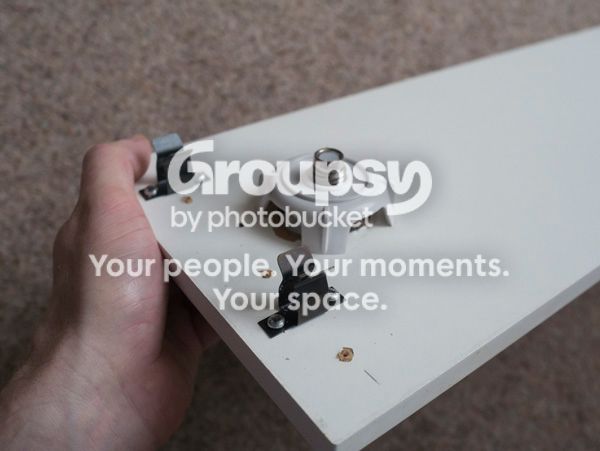

Ken, the clips arrived! YaY! Golly these things seem hard to find... so I'm grateful for your help.
Take the old clips off, mark up and fit the new ones...
Push the panel back into place...
As the new clips are metal I hope they'll be harder wearing then the original plastic ones which all mysteriously broke... I can only assume it was a domino effect and that once one broke the strain increased on the rest and they all gave up in turn. Hopefully this fix will last a good few years :D
