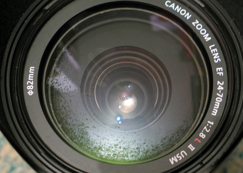

I ahve had this since new.. just noticed when cleaning this.... its on the inside..
Been out in rain a few times but not much more than drizzle.. obviously a pic makes it more prominant.. you ahve to actyually angle the lens to see it in real life and as i usually either use it in dark places or its on off busy then i hadnt noticed it before :(
cant remeber when i bought it but out of warranty..
what next ?: (

it doesnt lok like fungus which would be aaaaaargh... looks like damp/wet got in this so called weatherproof lens :(
Are you sure it's on the inside? A little while ago I had a massive problem with the coatings on the front elements of these lenses (and only these lenses):

hmmm.. nothing changes using anything on the outside so i preume inside.. hard for me to say for sure :(
looked at your thread.. can see final outcome that canon will replace any more you get.. but do you have any cost ideas for one ?
ps all the pics i ahve seen of fungus looks like growth and has a simmilar pattern..... nothing like mine
pps its around 75% of the edge of the glass.. round not inwards ..

We had 14 front elements of this type of lens replaced in 2015-2016. Prices including VAT were
£153.05
£128.20
£156.50
£156.50
and then Canon paid for the other 10.

I cant tell.. my missus says it looks on the outside and maybe coating.... Roll on the 9th october when i get it into canon..

Except the damage appears to be nothing to do with weather resistance, it definitely looks like damage to the lens coating.
Whether that damage is due to the coating being crap or user error is an argument between the owner and Canon.

So canon have the lens..
they just phoned me with a fixed cost repair of 156 pounds which i agreed to..
then i asked.. was it the coating on the lens.... she replied... do you use a lens hood.. the technician says its probably the cause..using a lens hood
WHAT!!! ? :(
So i asked them to look at the repair sheet i sent in showing exactly what the problem was with the lens...
oh right so its just the glass you want replacing?..
.duh :(
am awaiting another phone call when they are done.. i will ask if glass replaced and still same set price
Not amused :(
So posted the lens monday and I wlil get back tomorrow Thursday.. total cost £156.50 and from I can gather it is the film? at the front..
I wont know exact details until I get the work sheet they send back qwith it... also had my 1dxII cleaned and serviced.. so all done and back 4 days monday to thursday :)
All in all not a bad experience apart from the mix up of what was wrong with it..

hopefully they know whats what and whatever fix they have done means i can clean away with a blower and a cloth :)
Lens front element and zoom ring grip replaced.
Serviced and calibrated.
The unit has been examined, cleaned, checked and
tested to manufacturers standard.
Labour . . . : Replaced faulty/damaged
external parts
Spare parts . : RING, ZOOM
LENS ASS'Y, 1ST GROUP
Fixed Price Repair
From what I can gather...no matter what was wrong with the lens its a fixed price repair which was £156 total
