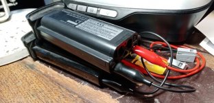

I recently aquired a 1D MkII, At the right price, free.
It came with two batteries but no charger.
So a bit of 'Bodgit & Scarper', aka Heath Robinson, this may or may not work. I'm trying to charge them from a charger for RC car batteries
Did it work? I had a 1D mk2 back in the day, but can't remember what the charger was like. I can remember you had to flip out, then twist the lock on the battery to remove it, but not what the charger was like. I took some of my favourite photos with that camera.
It does work!
One of the packs is dead, so I took it to bits to find it's got 10 x AA NiMH 1800mAh cells inside.
I'm handy with a soldering iron, so I got 10 x 2500mAh cells and a more sophisticated charger from a RC models place. Charger connects the same way as I don't have the pukka Canon plug and it's not something I can get from RS etc.
