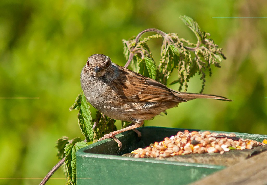

The only "good image"

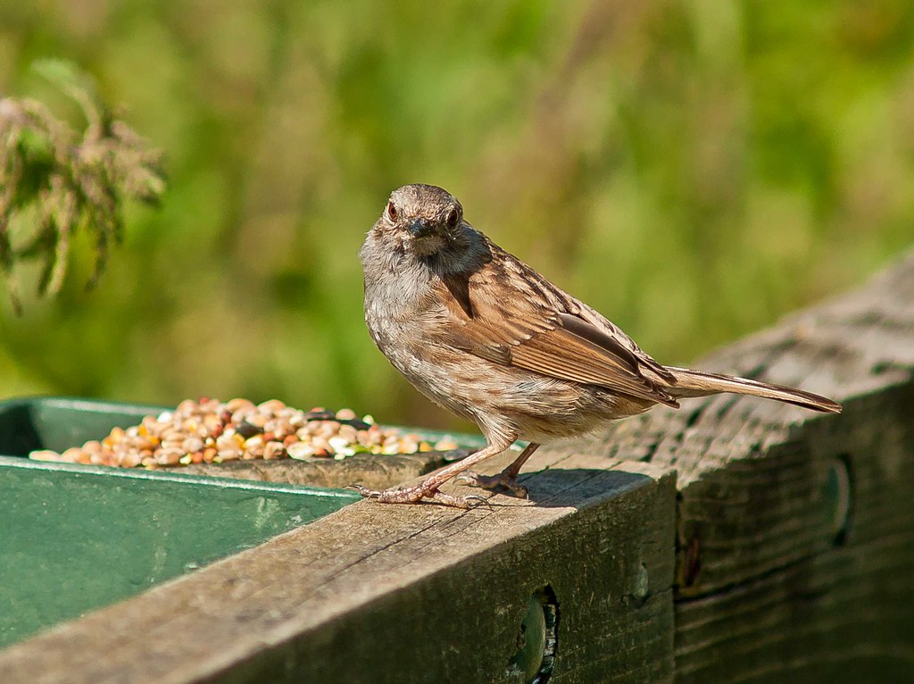

The only image with very slight corruption (thin red and green bars)

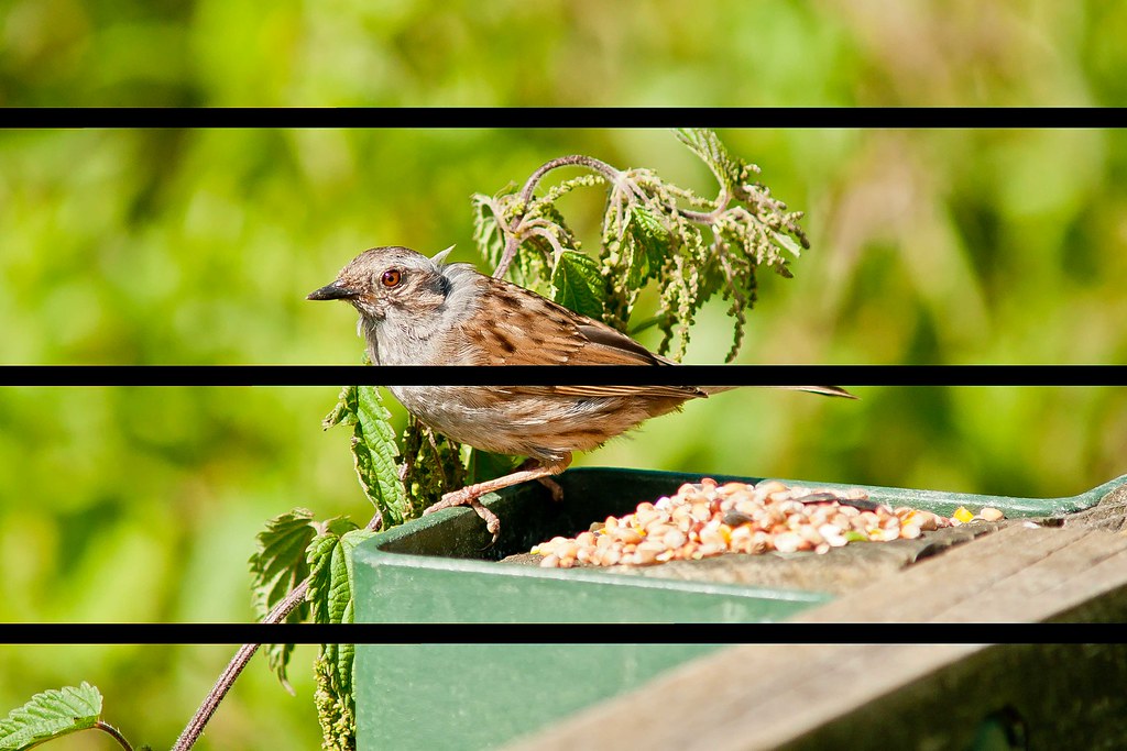

This image is typical of all the rest, exhibiting obvious black bars.
If you've tried an old card in your camera with the same lens / settings etc and you have no issues at all, then it would suggest a card issue to me as everything else has remained static and not changed...
Did you format the new card for your camera ?
I'd be returning them I think as faulty - where did you get them from ?

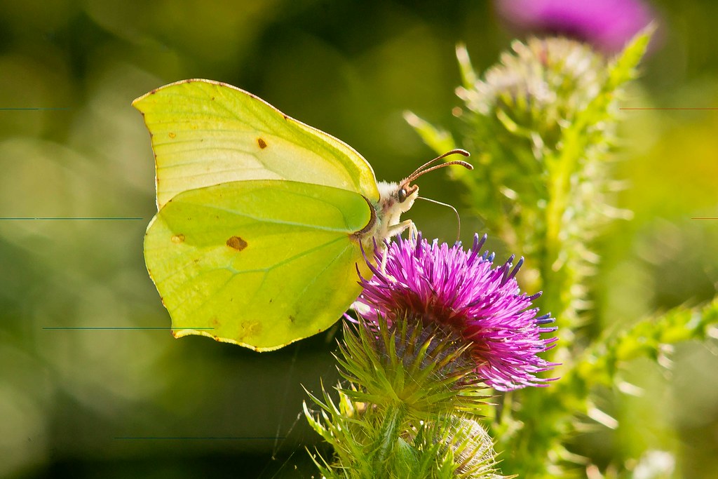

Here are the latest images from card number two. To say that I am very frustrated does not even come close.

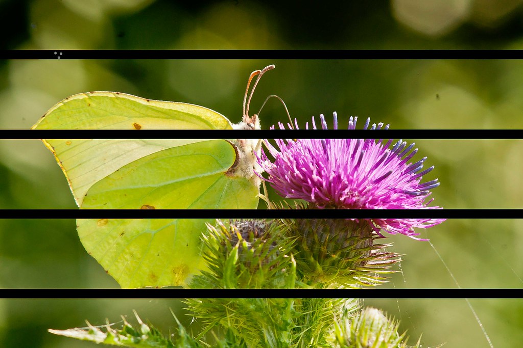

On this image there are three grey dots on the top black band. This is where I tried to clone out the black band, and instead of using the background colour, it simply turned grey?
I tried to clone out the blue and red lines on this image, but it would not let me.
