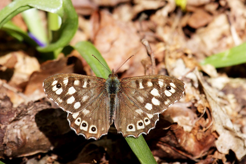

Here's a butterfly pic taken yesterday. It looks OK. But, I keep looking at other peoples pics of birds, where at a 100% crop you can see the feather detail really well. At a 100% crop, this begins to look pants.
Has that shot had any sharpening, one thing I have found is when resizing for the web it need that extra bit, and defenatly with my 100-400, that dosent look too bad, but dose improve with a slight sharpen in photo shop.
Oh yes, quite a bit of sharpening on this one, both prior to resize and afterwards. All of my shots with this lens need lots more sharpening than with any other lens I own.

There doesn't look to be anything really wrong with the butterfly, but it doesn't have the eye popping detail we get use to with some of the insect photos on this site. It's pretty hard to say if there is a problem with the lens from here. Maybe you can show us some of your best shots taken with the lens?

I've just down had a look at your flickr posting of the butterfly at 200% and to be honest, I can't really see anything amiss.

Thanks Terry - BUT, most of the insect stuff on Flickr was taken with my 55-250 last year. That was a corker and produced some great shots - Far better than with this damn lens.

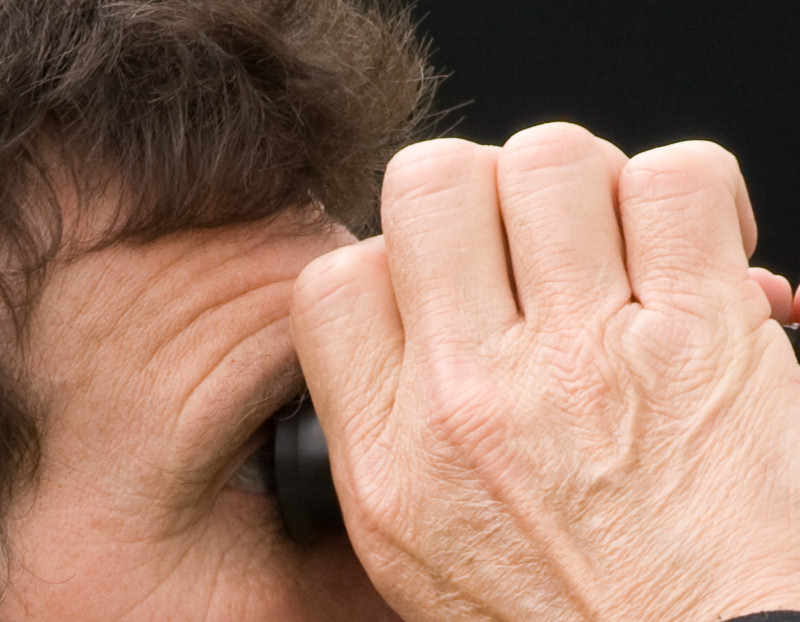

For reference here are a couple of 100% crops from my old 100-400mm @ 400mm F5.6 (Took a while to find them, seems I rarely shot at those settings!)
I'm looking for some 400mm F8 ones now.
Richard, I think that last one just about sums up why I feel so damn despondant with my lens. To me that is good definition at 400mm F/8 - Exactly what I think I should be getting, but am no where near.
Great examples, thanks

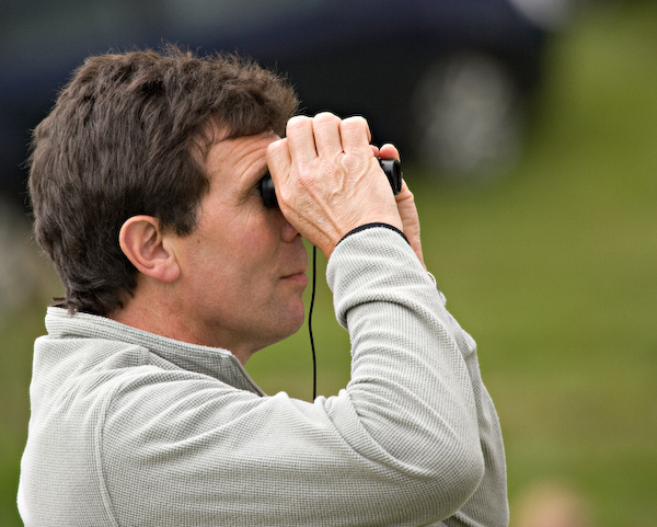

I think mine may be a reasonable copy :shrug:...a candid from last year - 400mm at f/5.6, and little in the way of PP :)
Is that a 100% crop? If not it would be worth posting one - It's not really possible to tell much from a full size image resized for web :)
